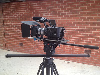

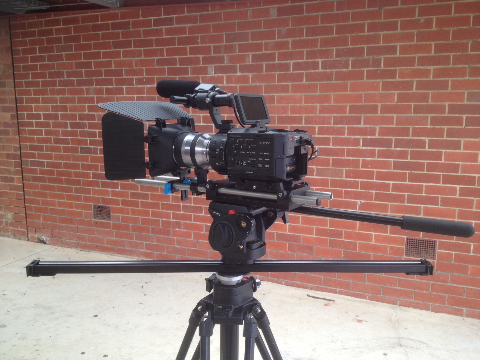

What I am enjoying is using the FS100 with a slider and a cheap plastic matte box that allows the lens to zoom in and out. Feels very cinematic and this setup is great for lots of shots where there's time to set up a shot. Ive attached a picture of my setup. Im not using a follow focus cos the gears seem to restrict my ability to focus (too much turning!)
