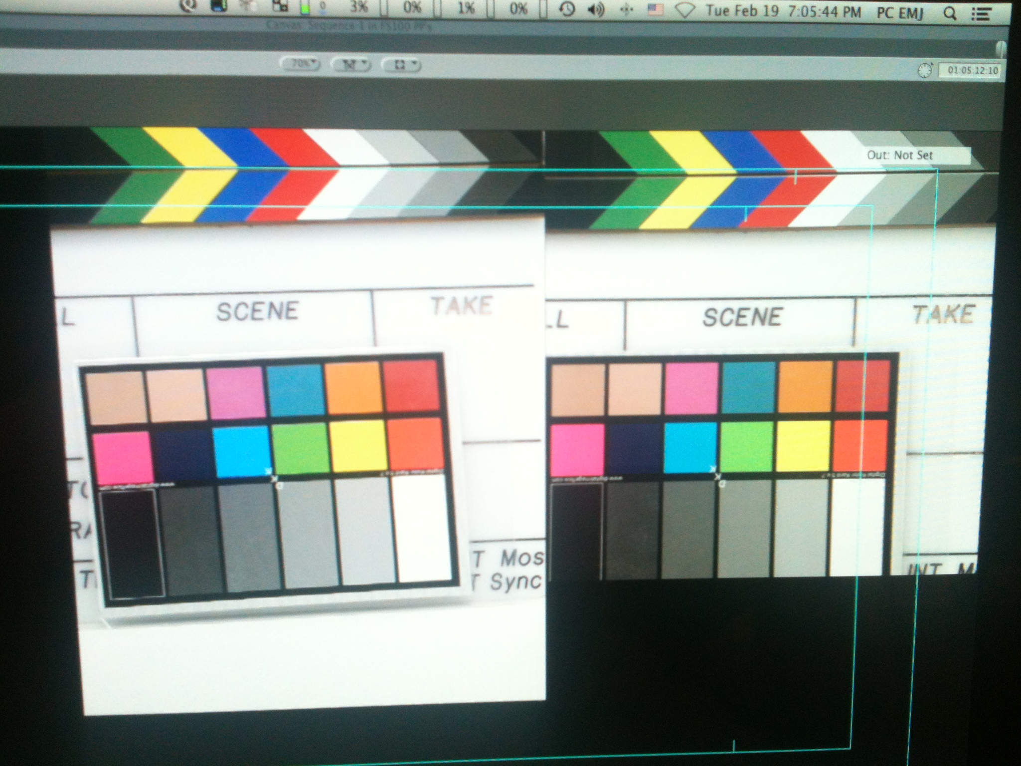

This is a hasty mobile snap of the D800 and FS100 matched PP side by side. Both were white balanced with custom presets, in camera.
