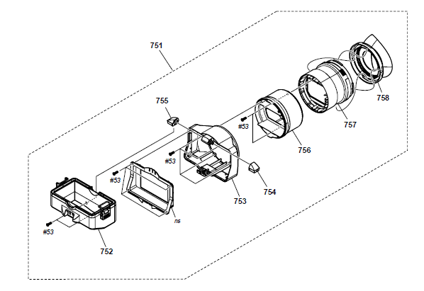

While I love the camera, there are several parts that are cheaply made and break easilly. I've been on a Sony scavenger hunt looking for the following:
1- Stock Viewfinder - a pa dropped mine and I cam't put humpty together again. Although I rely on my Zacuto evf and z finder, I really want to replace the stock viewfinder.

Old August 22nd, 2013, 05:49 AM   #5
Location: Boca Raton, FL
Posts: 3,014
Re: Replacement Parts source???
Individual parts
X25815831 VF FRONT ASSY (Ref 752)
X25815841 VF REAR ASSY (Ref 753)
426921601 BASE (R) HINGE (Ref 754)
426921501 BASE (L) HINGE (Ref 755)
426921401 JOINT VF REAR (Ref 756)
X25815851 LOUPE ASSY VF (Ref 757)
387820802 EYE CUP (Ref 758)
308020621 SCREW TAPPING P2 (Ref #53)
Complete Viewfinder block assy.
PN: A1826121A VF BLOCK ASSY (Ref 751) – Includes all parts inside the dotted line.
To order in the U.S. contact one of the following Sony Authorized Part distributors
Andrews Electronics Inc
661-257-7700
Andrews Electronics
Herman Electronics
www.hermanelectronics.com

there ya go. so for future reference its name is "Viewfinder Block Assembly" and its $147.97
