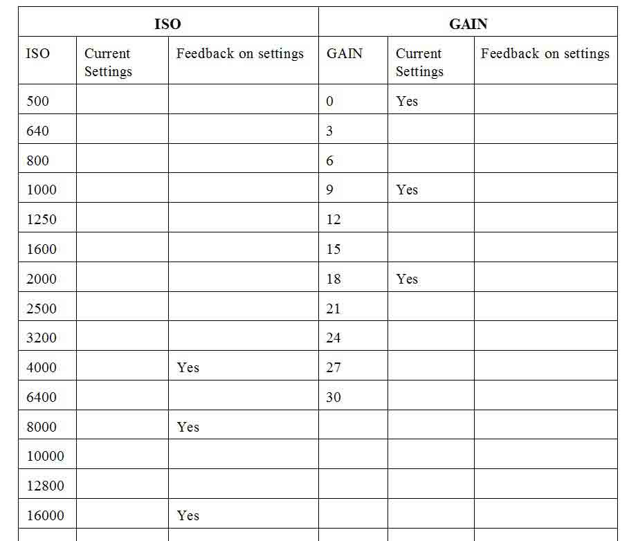

Rob thanks for the info. I made a chart so I could test the different settings to get the most out of the six available presets. I do interviews with b-roll and a lot of the time the b-roll is very run and gun. So it may take me a while to figure out what is the best walk around settings but this is what I am starting with.
fs100-by swapping gain & iso i can now store 6 presets!-iso-gain-chart-l.jpg
