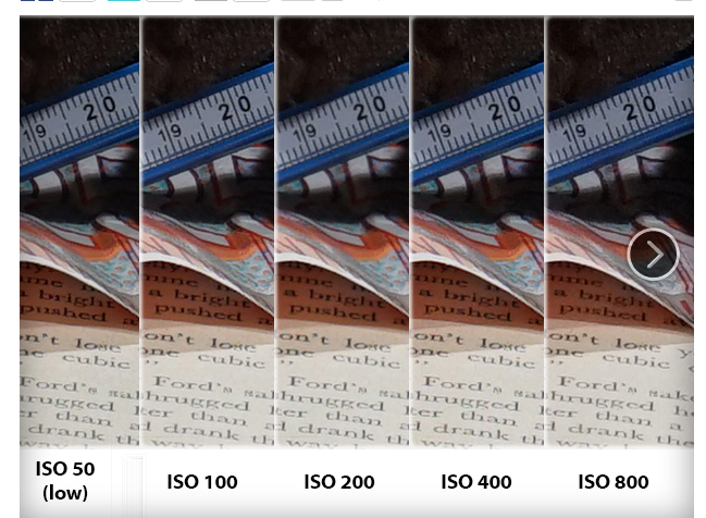

I've worked with large single-chip camera's all my life (well, since 2000 - before that there were none) as a professional photographer and I've always had ISO values as low as 50 or 100. Never have I experienced any problems with lack of detail in the highlights, provided the exposure was spot-on.
These are shots made with a Sony chip (very comparable to the one in the FS100). There is no degrading of the image quality in the lower ISO-shots. Cranking up sensitivity is known to have numerous negative effects, but the contrary has never been true.
I can't help wondering why this cannot be achieved when a large-size chip is incorporated in a video camera…
Closing the aperture is the last thing I want, because what's the point of having a camera with a large chip that produces beautiful shallow DOF, and then close the aperture so that this effect is completely wasted? Besides: closing the aperture to 16 or 22 on most lenses will have a very negative effect on sharpness and chromatic aberration. The same is true for ND's: every extra layer of glass, no matter how high the standards, will negatively effect picture quality.
By the way: 'Negative gain' is something like a 'cheerful depression', is it not? :-)
