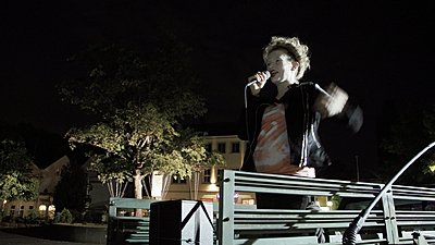

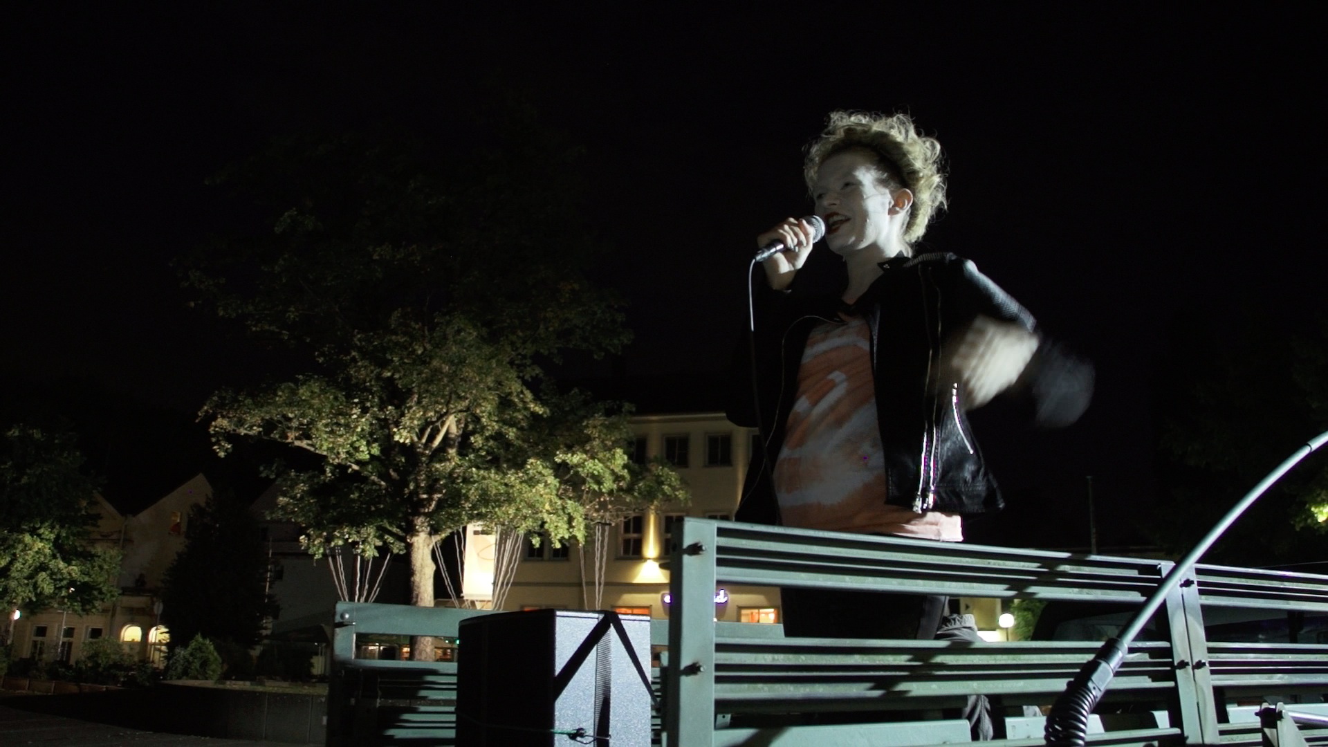

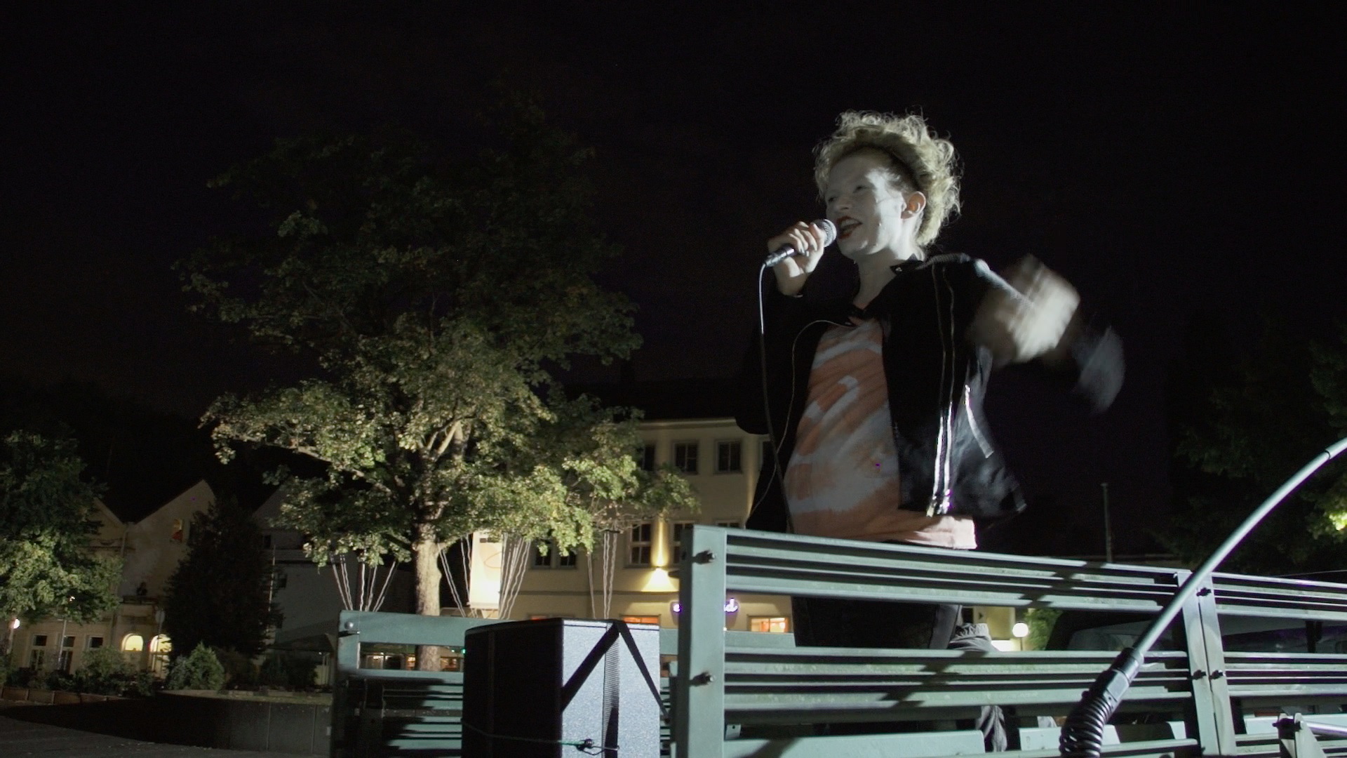

Here's an example:
Shot during the night with very hard lights for an outside theater.
The girl wears black leather and has white makeup and the pic
shows some direct lights in the background. Pretty much what you
never want...
a) direct out of cam with Frank's PP (without either highlights would have been burnt out or the dress would have been totally black)
b) quick cc in FCPX
c) quick grading with filmconvert

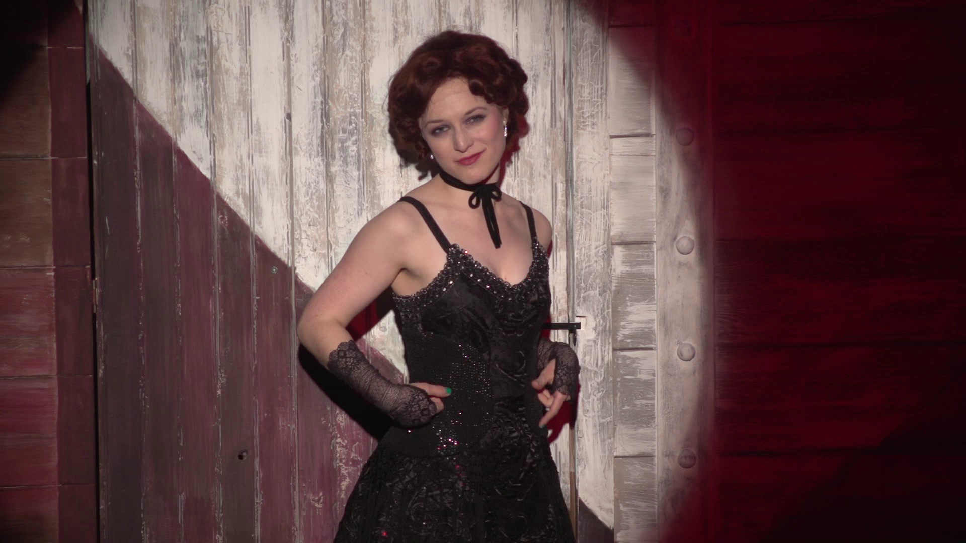

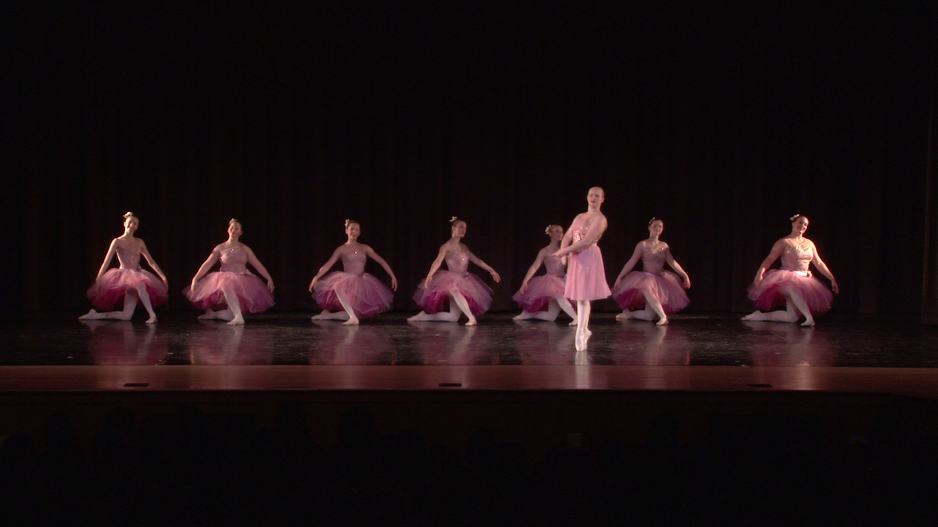

Dave. Yes. light color (gels) are an issue I too always have to deal with. I do set up my FS100 (wide shot) to my right so that I can easily access the controls and see the monitor. Of course the iris control on the FS100 is slow and not very responsive.
I always set the color temp to 3200k which it the temperature of theatrical bulbs. Sometime there is a spot or special in the 5600k range but I have not had any problems with that (see photo from Cabaret).
The problem which I tend to have are with hot spots on the stage in the wide shots (see dance photo). Thought this photo is not to extreme you can see the dancers on the right and left are a bit blown out. I would lower the iris however then the opposite will happen and I will have the majority of the shot underexposed.
When I work with amateur light designers that is when over saturation really happens. Not only does the video look like crap but from an audience member's perspective the lighting looks bad as well--however I can only capture what I am presented with.
Picture Profile suggestions-vlcsnap-2014-09-16-11h54m31s26.png   Picture Profile suggestions-vlcsnap-2014-09-14-17h43m17s61.jpg
