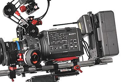

I use the Anton Bauer QR-PD-HDV Battery Adapter on my FS100 I also have a Anton Bauer FGM-S Gold Mount that works with the FS100 (discontinued but maybe find one used and save some $)
Abelcine listed Anton Bauer QR-PD-HDV in an FS100 accessories post

Ray is your wireless receiver attached to the plate with velcro?

Yes, I use velcro but there is a standard threaded hole and cold shoe mounts as well
