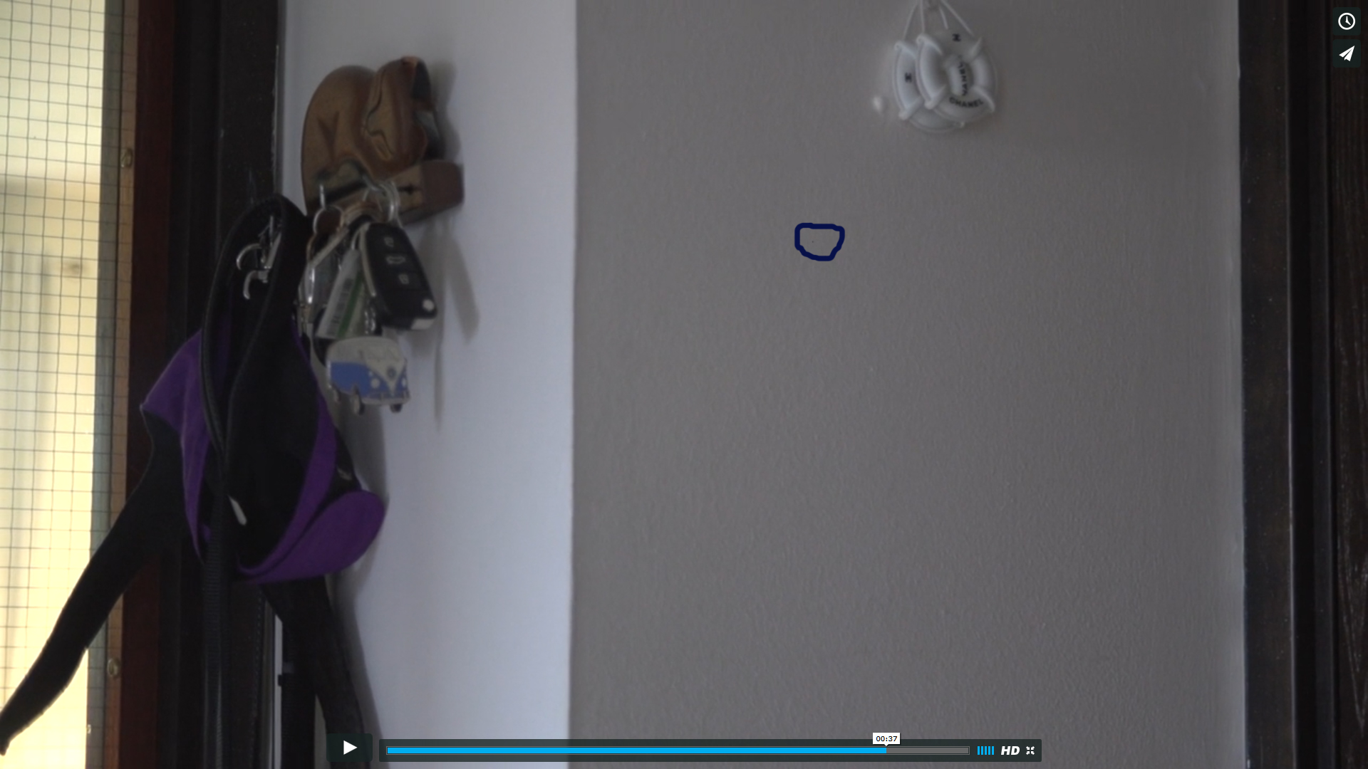

Does anyone know the button combination to access the FS100 service menu? I have a dead pixel which I need to get rid of and hoping to fix it myself through the service menu before sending it in for service.
As a side note, it is not a hot or stuck pixel (red,green,blue or white) which shows up further when camera warms up or gain is raised, but a constant black(dead) pixel which is permanently there, just off centre of screen.
No amount of black balances fixes the problem.
Any advice re-above would be appreciated.
Thank you.

Hi Christopher, thank you for your response. I have tried many things including multiple black balances to remove the black pixel to no avail.
If someone can help would really appreciate. There must be a service menu for the FS100 which would allow me to mask this pixel but what is the procedure to gain access to it. I have searched online and found no information. Here is a still showing the black pixel.
Many thanks.

John ~
I guess another thing you could try is the process that is reported to work on the A7s. If you dig around on Google there are reports saying put date forward by two months turn the camera back on. The procedure is outlined in the video link below. In the video the guy says one month but I have read that it depends on when the date the program masking circuit is set to activate. Don't fully understand what that means but it is said that two months advanced date is the trick. I don't know if this will work but I guess it's worth a try.
It may not work as this string of DVInfo posts indicate it needs a service fix. Check the last post.
http://www.dvinfo.net/forum/sony-nxc...uck-pixel.html
