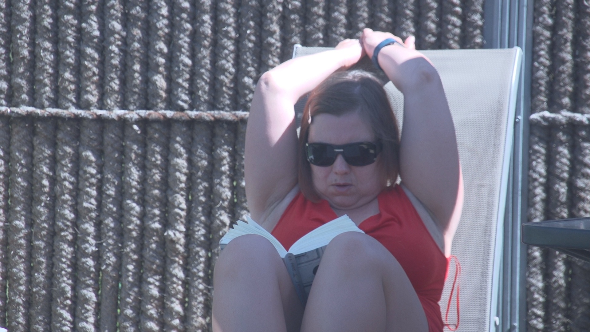

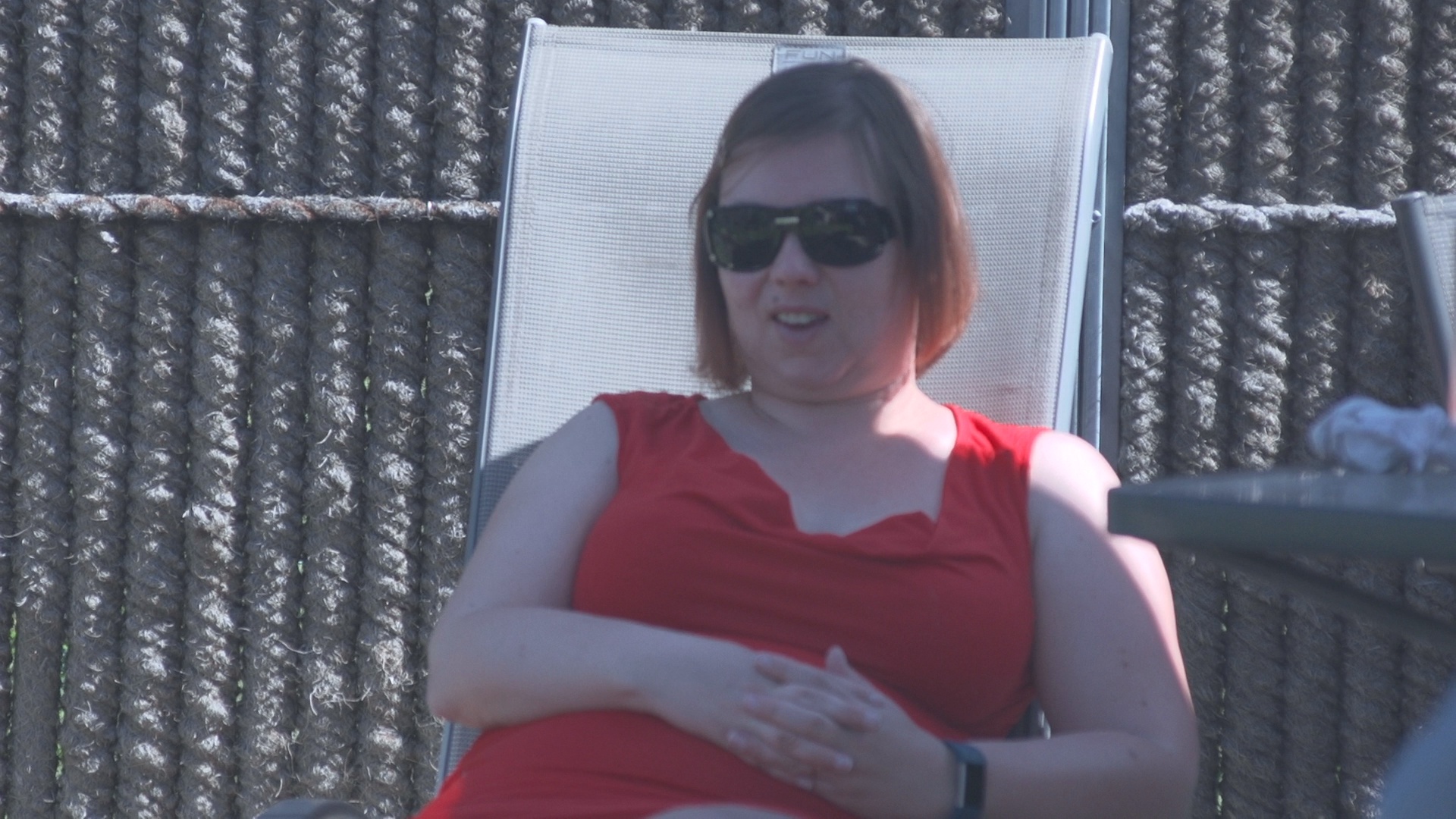

hi Dave,
I just have the lens and did a quick test outside against the sony stocklens 18-200mm F3.5 - 6.3
I used a variable nd filter. This fitted directly on the nikon lens without a extra adapter ring. great.
I thought I would have more focal length with the nikon during the crop factor but I didn't see it.
Looks like about the same distance fully zoomed in against the sony stocklens.the DOF seems also about equal. that's strange, not?
Will have to test further inside. I attached a still from the nikon lens fully zoomed in and from the sony fully zoomed in.
The peaking works.

now with the samples
Nikon ED Nikkor AF 80-200mm 2.8 ED-nikon.jpg   Nikon ED Nikkor AF 80-200mm 2.8 ED-stocklens.jpg

200 mm is 200 mm - so long end of both lenses will be the same field of view.
If both lenses are wide open, you should have less DoF at 2.8 than at 6.3 when at 200mm.
I'm personally not crazy about variable ND's on long lenses - but with the AF100 you may be stuck with it outside.
Do your next test inside - wide open at 2.8 with no ND and check out the image. Make sure you have some space between your subject and your background.
