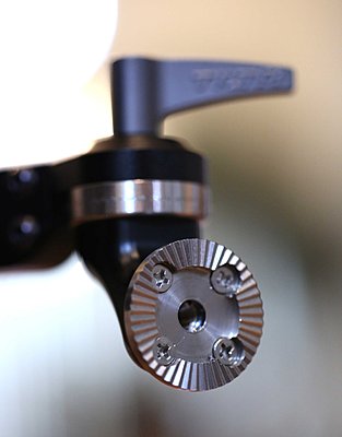

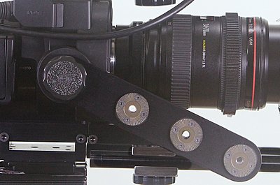

The handle on the 700 is a lanc controller. You can simply get or make an extension chord for it and mount a rosette on your shoulder rig to mount the handle.
I sell just the rosettes and also handle extensions just for this purpose.
I will also be making wooden handles for the 700 in the near future, that can control the camera. I will be "decoding" the different buttons on the handle. This is usually pretty simple just varying the resistance on the pins will cause different action by the camera.
The rosettes and handle extensions are available here:
Sony FS700

You are bringing very interesting question Mr. Ekbergh.

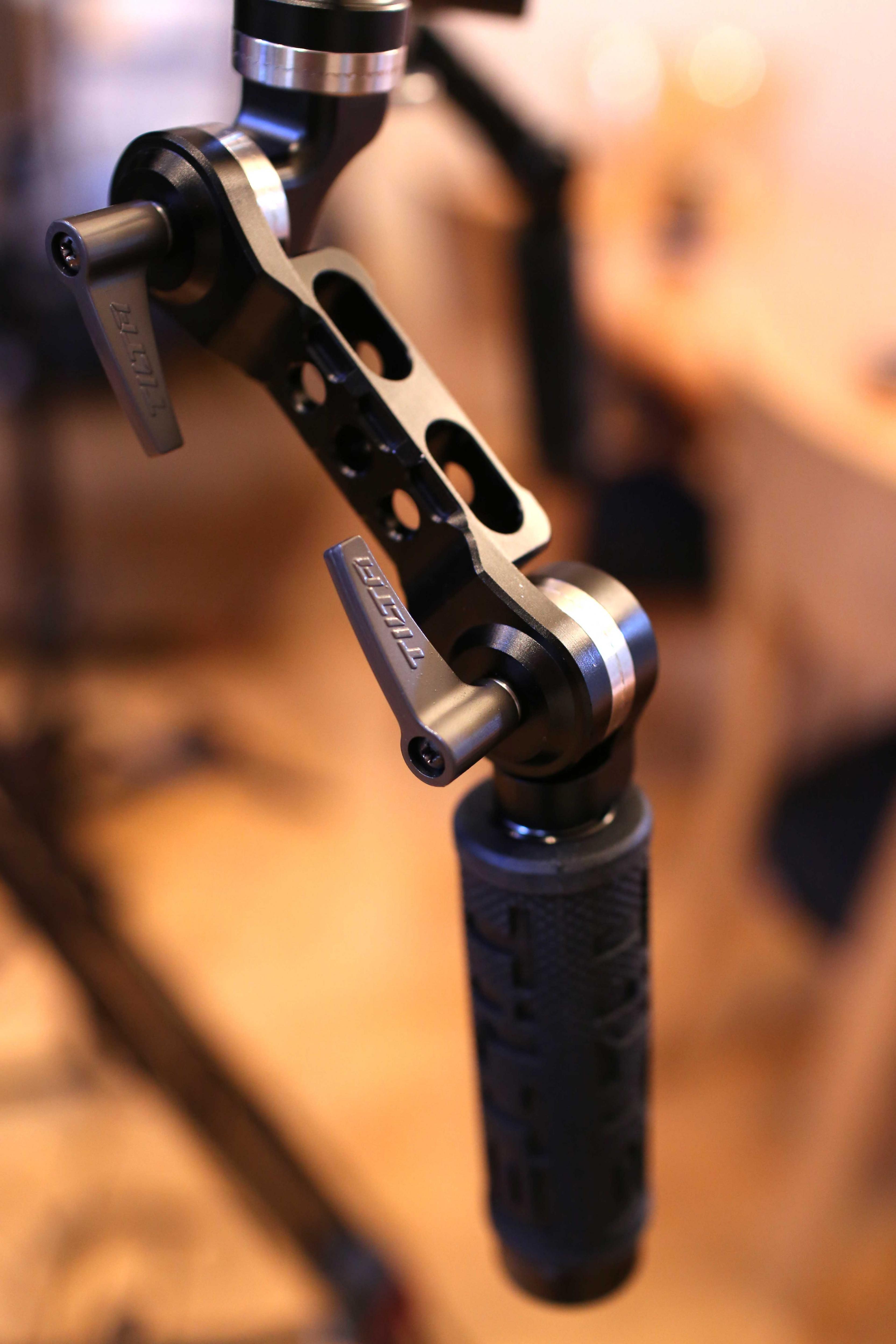

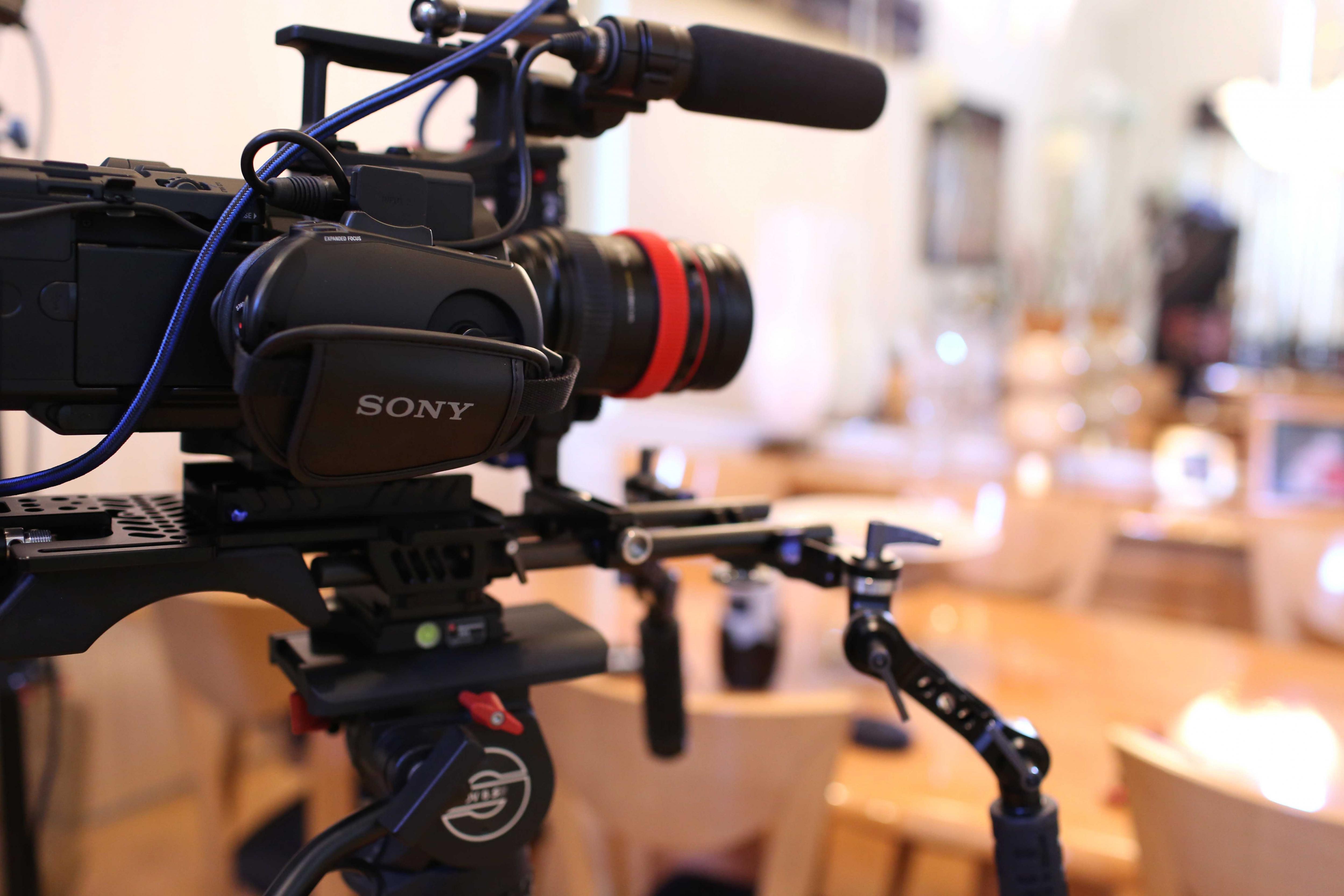

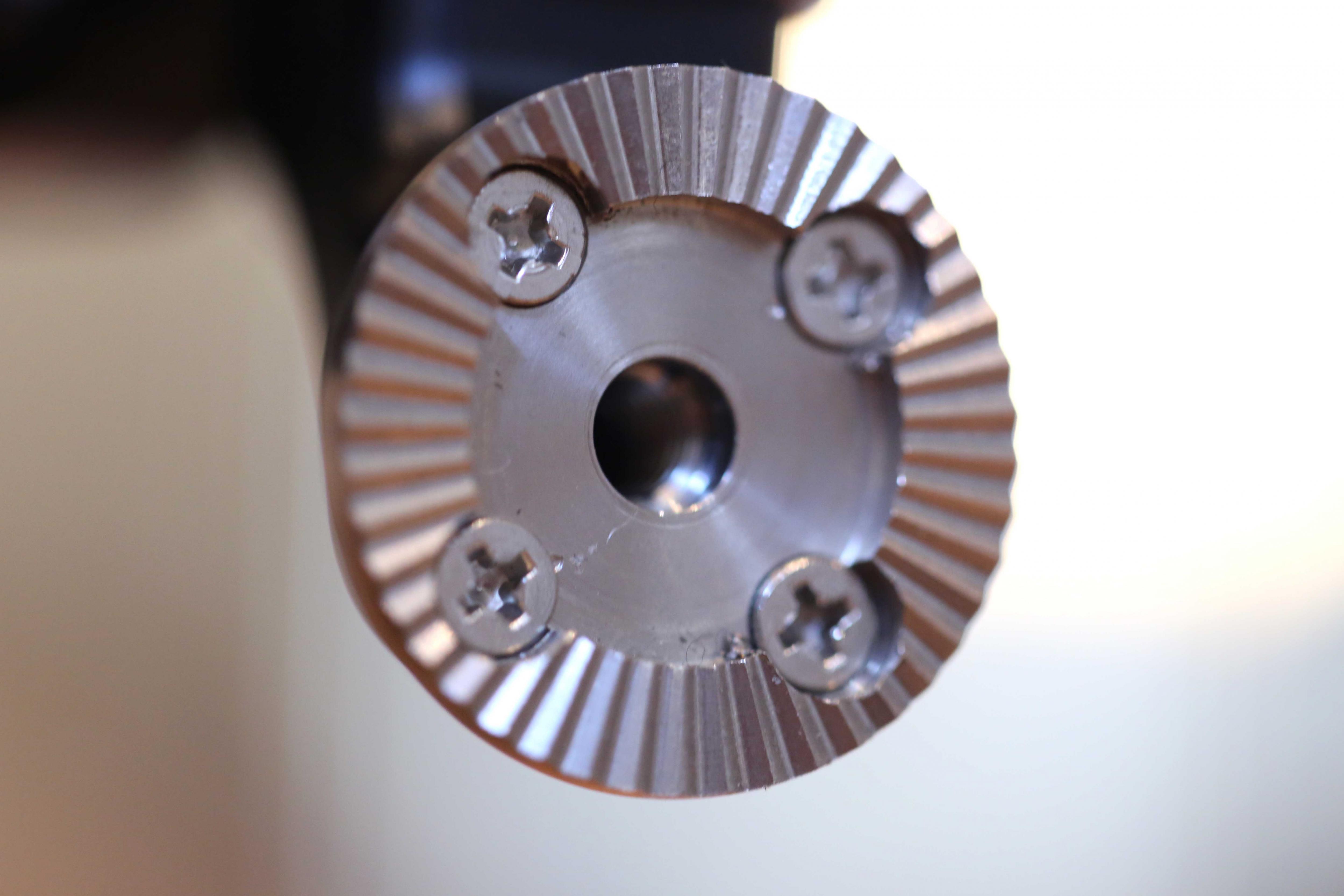

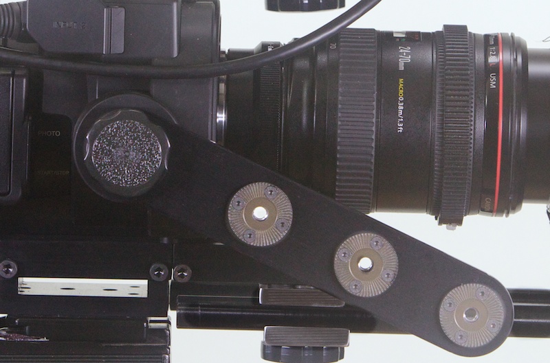

I have TILTA rig which already has a rosette but it is not an Arri standard rosette but a smaller. What would be actually cool is to have an adapter rosette that would go from TILTA to the one that you are manufacturing, that would help relocating the Sony's handle.
The second options would be to use already provided opening on the metal and install your rosette that way.
Just something to think about. Obviously cable extension will be used. I am attaching couple of images for your review. What do you think?

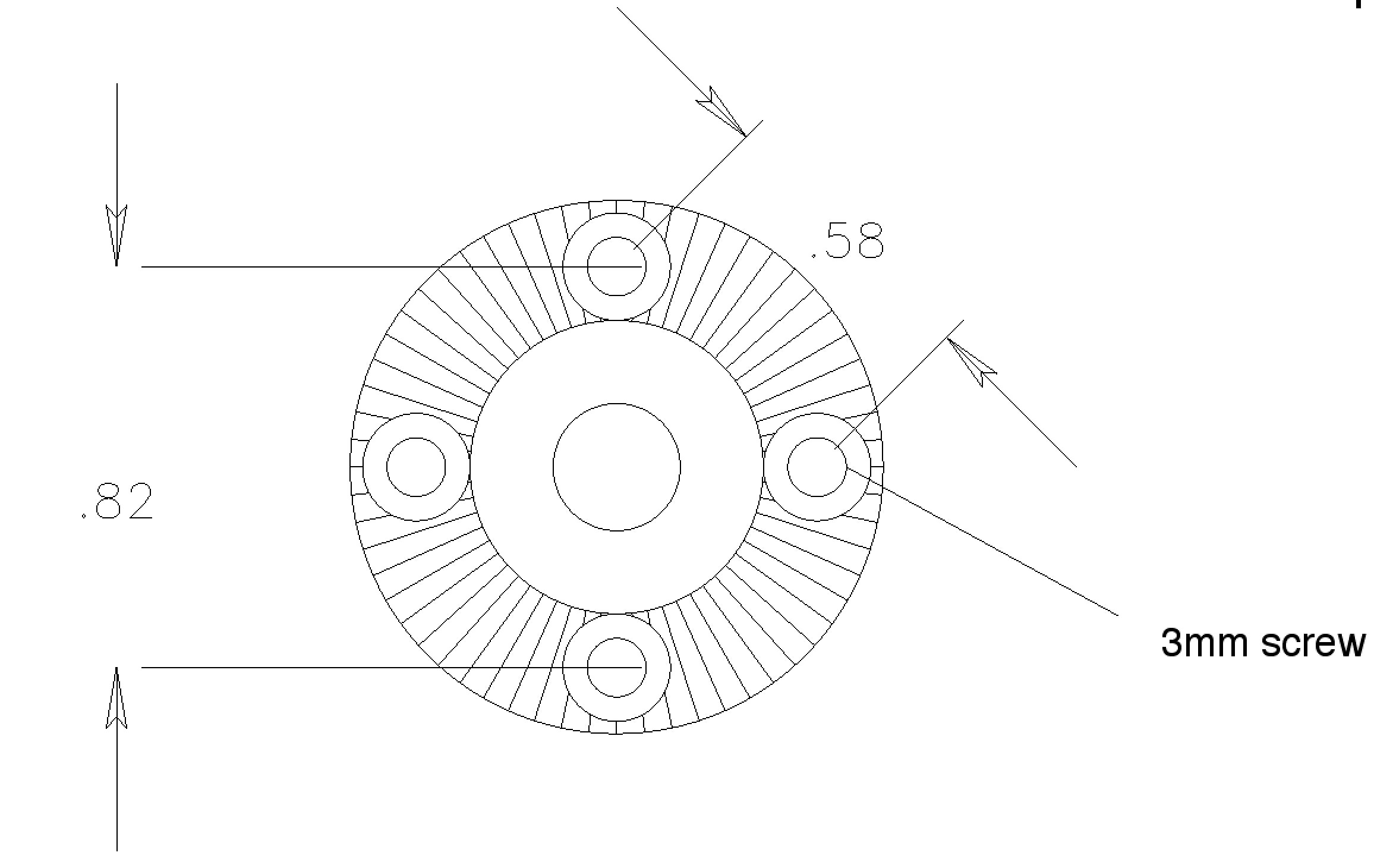

Here are the screw hole dimensions on my rosettes in inches. These interface perfectly with the 700 handle. There are 60 grooves or one every 6 degrees. These are center to center dimensions. Use calipers to check your centers.
If the screw hole centers are the same you could simply switch rosettes. My counter sink is for m3 screws, this is easy to change though.
I make a few other rosettes as well, but these are the right ones for the 700.
You can contact me directly and we can Skype if you need more info. BTW call me Olof the Mr. thing makes me feel old.
