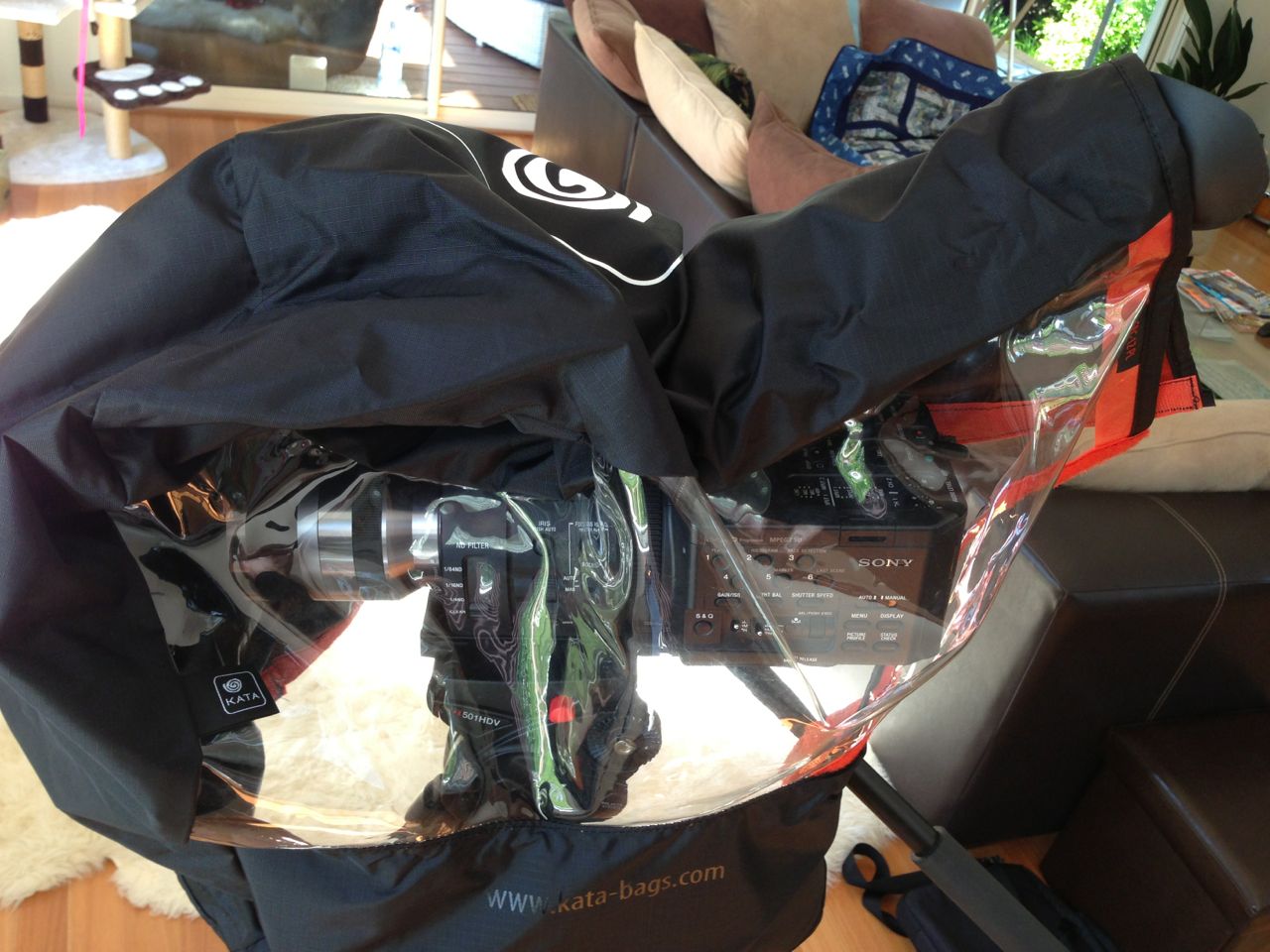

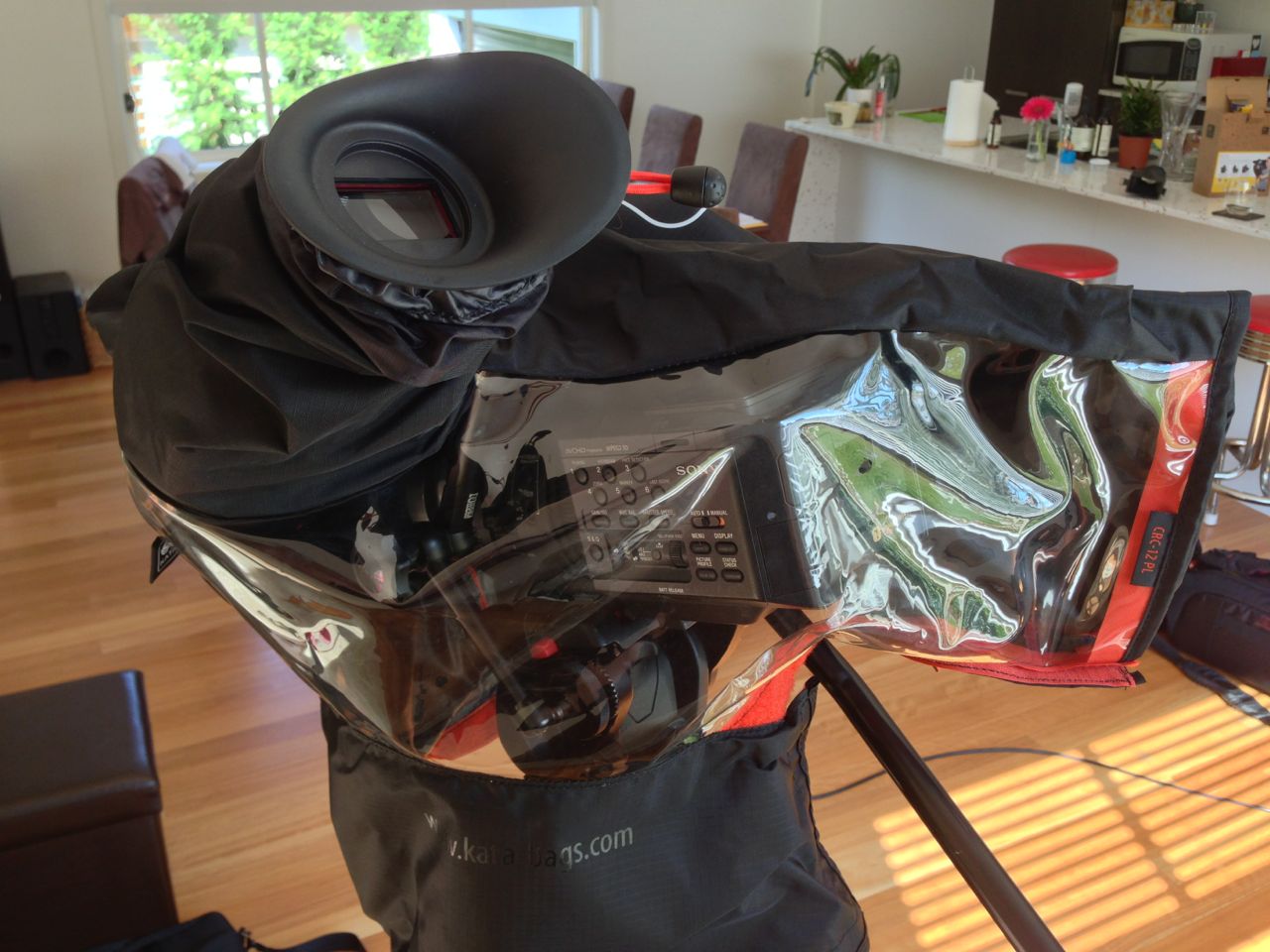

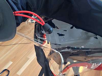

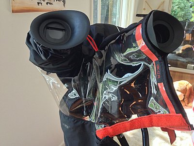

I still could not find any details of the camrade one. Just a news post on their site, no details. So I ended up getting a Kata CRC-12.
CRC-12 works as well as CRC-15 it seems with evf coverage as well.
The 15 does not have an EVF sleeve, you need a shower cap or something else, and I wanted to try and get more clear visibility on the left side of the controls. It seems to me they both fit and have tradeoffs. The CRC-15 seems to be longer and has a uniform tail end, no* evf sleeve, possibly more streamlined. The CRC-12 has a drop down back more suitable for the EX3 (and DSLR), which is unneeded, but means there is more clear pvc on the left side and an evf sleeve.
I've put it on and pulled a few things off and on, and rearranged viewfinders, and it seems to fit pretty well for something that is universal. I've not shot with it yet (nice weather down under at moment), nor have I checked coverage with a matte box and rails, nor tried it handheld (still debating my handheld setup). It looks like it will be fine, but no guarantee.
I did put my 70-400mm sony with adapter on it to test the length (as well as stock lens), and it covered to just over the hood, with only a little slack at the back.
I've had the viewing tube off the back, pointing out to the left (which is only useful at eye level as you then cannot tilt up). I can arrange the pvc to see the lcd folded to be viewed from the back, the left at the back, and folder over to look down from the top, all good.
EVF off the left side with a Noga arm fits in the sleeve nicely (going to get something more solid off the handle soon) and there is enough movement to have it at the front like shoulder mount, out to the left, or towards the back.
This will do until (IF) something comes out. Be interesting with the new sony models, the fs700 really has to carefully keep its place amongst the newbies. Maybe its not long for sale as the F5 drops in price with more competition. Slightly different body shape, and maybe thus no rain jackets :(
The only other one I got close to considering was a portabrace rain slicker for the FS100. I emailed them asking if it fit the FS700, (concerned about access to ND filter wheel) and/or if they were developing something…. No answer…
PortaBrace - Video Camera Cases - Professional Video Bags, Camera Cases
or the petrol Pr410 might fit, and if I am looking at it correctly might have a zip-down front where a zoom lens that extends might function underneath some shelter unhindered. If I had a complaint about the use of the crc-12 on the fs700, if you are using a extending zoom lens, its difficult to zoom quietly. I don't plan on doing any zooming during shots. If I did and was always shooting in weather, I'd wait and use the 2x digital crop zoom of the lens coming out, or maybe the petrol case.
DerranNL: Review: Raincover for the NEX-FS100
Here is some pics, stock lens, 70-400 sony amount (with adapter), lens tube on/off, alphatron evf on/off (you can tuck the evf sleeve and poke it in when not using).

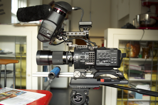

I've attached a couple of photos and have since relocated the handle to the forward bar next to the lens - not a drastic change. Is there a solution I just haven't found yet?

Cool rig. So on a boat the most stable image is two feet on the deck handheld yes? :)
The crc12 would be more likely than the 15. Has far more vertical stretch. There is a fair bit of play between the mic sleeve and lens part but your rig will certainly put it to the test.
I could measure the max stretch between the two areas if you like?
I presume your setup there is for balance, though it looks like it would be quite front heavy.
Is it pretty balanced like that?
Is that the stock black lens or ?
Kieran Steele is offline   Reply With Quote
Old February 11th, 2013, 01:04 PM   #10
Join Date: Oct 2008
Location: Vancouver, Canada
Posts: 27
Re: Rain Cover
Kieran, I fitted the CRC12 and like you say while not perfect - it is just long enough to close on the tail end without any add ons - it did give the most functional fit so, in the end that's what I went with. Although with a V-lock or recorder attached off the rear rails it just wouldn't work. It provided a snug fit around the EVF and the excess material around the sleeve wasn't an issue. Thanks for the offer to measure but Genesis Matrix had one in stock to try on.
Stability on small trawler off the Pacific Northwest Coast in winter cannot be had. Dry land still feels like it's moving. The cine saddle got a lot of use though.
That's a Zeiss C/Y 180mm - not a lens to use on the boat. Mostly stuck to the Tokina 11-16mm and the Zeiss 35/2. Balance is a bit of an issue even with those smaller lenses. I recently added the Zacuto Handle relocator which has revolutionized the positioning and stability. The total weight is still pretty low so unless you're handholding in the same position for a long stretch it isn't big issue yet.
