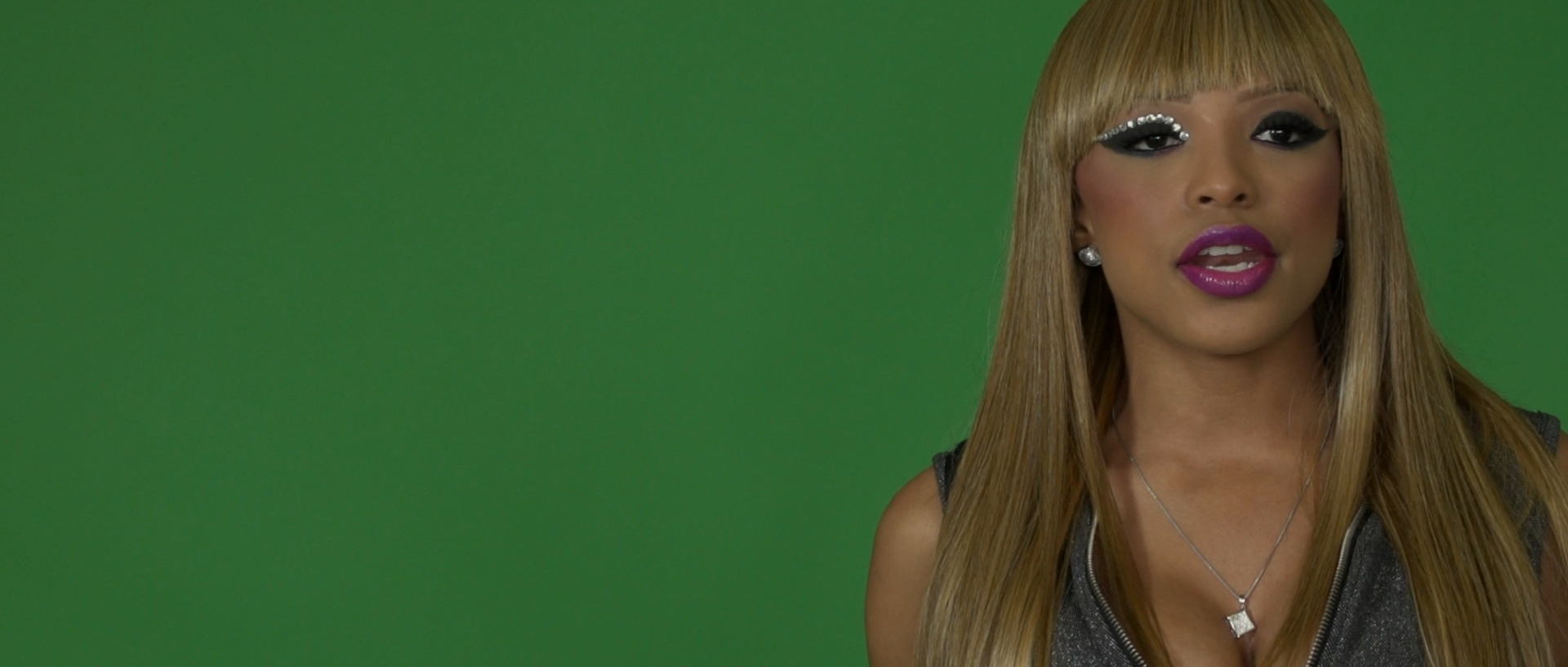

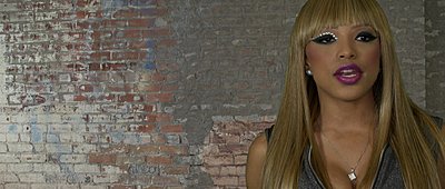

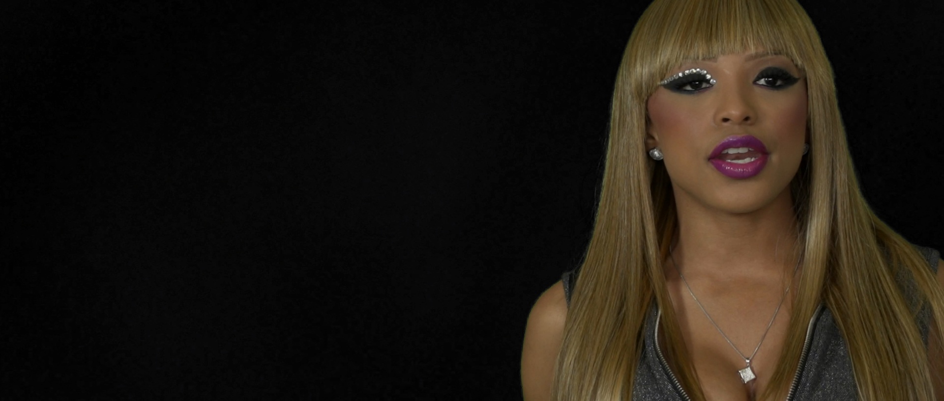

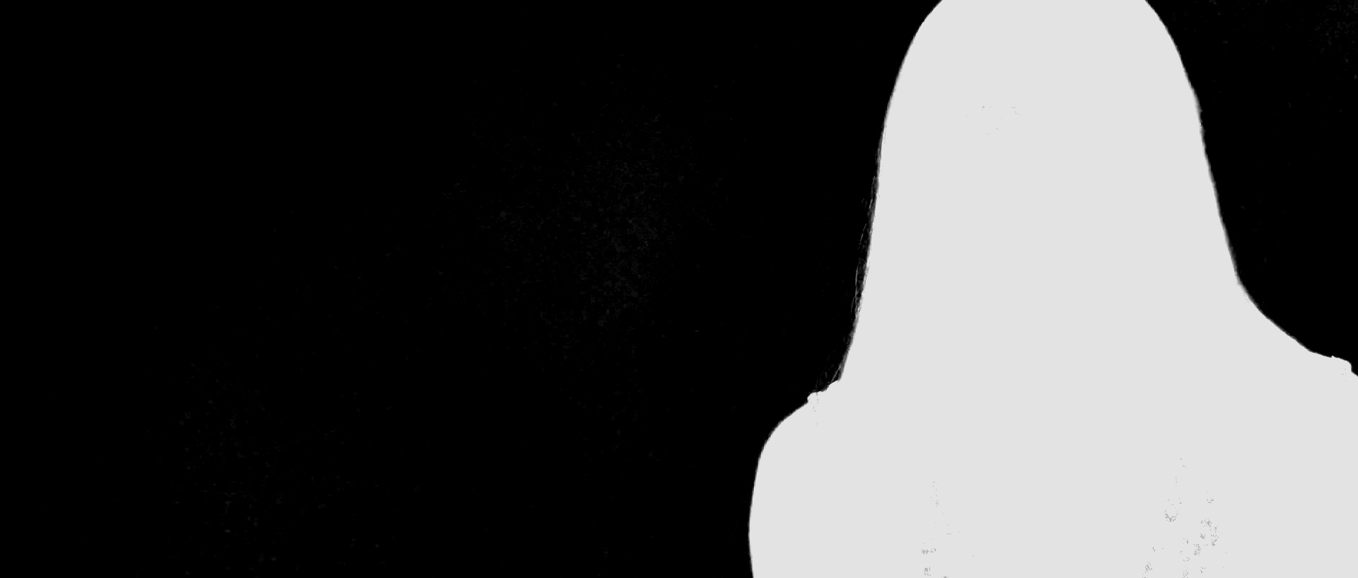

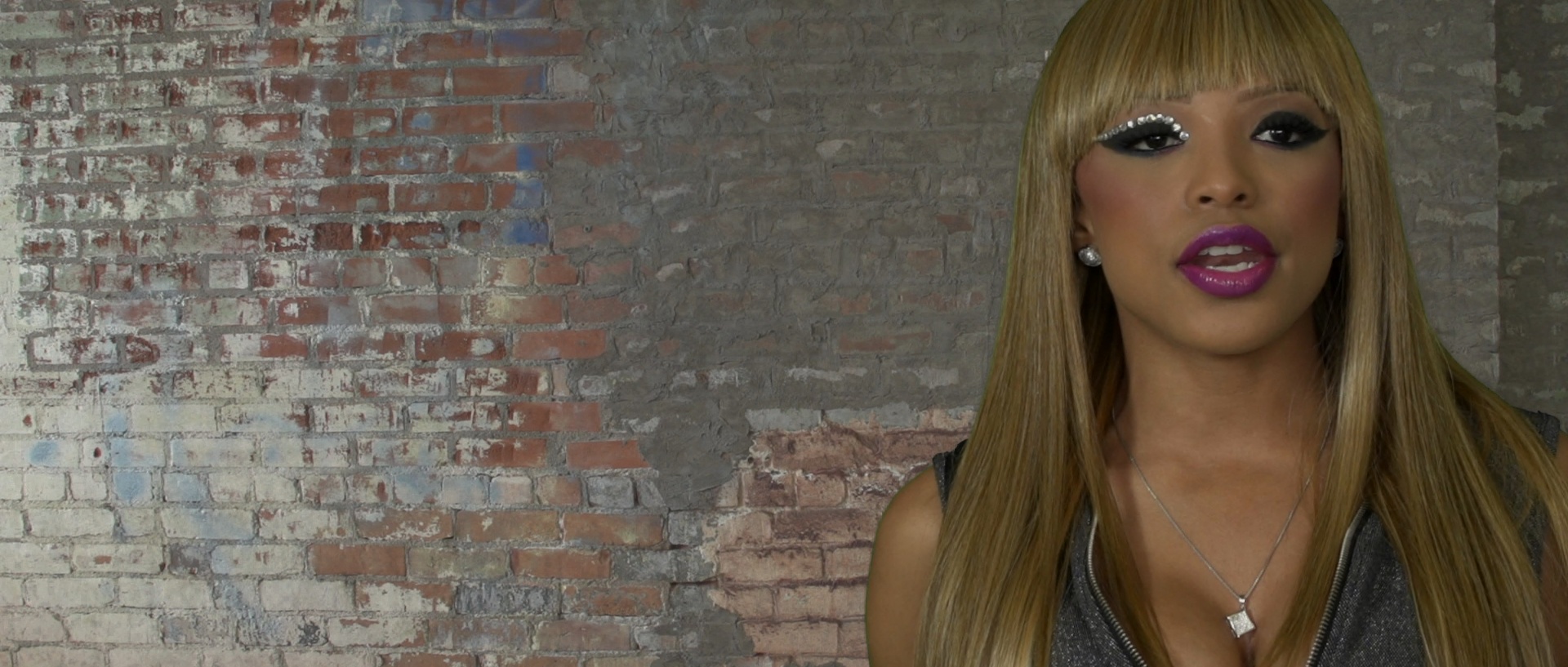

I shoot this on my FS700 with the stock lens Screen grabs from Sony Vegas 11 it was not lite very well.
Disappointing image quality, especially for chroma keying-image7.jpg   Disappointing image quality, especially for chroma keying-image6.jpg
Disappointing image quality, especially for chroma keying-image5.jpg   Disappointing image quality, especially for chroma keying-image4.jpg

How can you quantify sensor and processing issues when the image being projected on the sensor by the optics is of poor quality? The images are not even in focus, the creases on the cloth appear to be in better focus than the people. . Thats like using an SD monitor to evaluate HD resolution.
I agree that the chroma resolution from the FS700 is lower than would be expected from the PMW200 or a similar well designed 3 chip camera, but what I see in your test images falls well short of the performance I get from mine, but this looks to be mostly down to poor studio setup and focus. You might also want to consider dropping your exposure of the green a bit too and doing something with your lighting to provide better separation from the foreground to the background. It is over exposed and the green is very washed out and spilling all over the place. The green should not be at exactly the same exposure level as the foreground skin tones, that makes pulling a decent key tough with any camera.

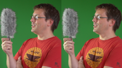

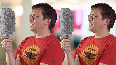

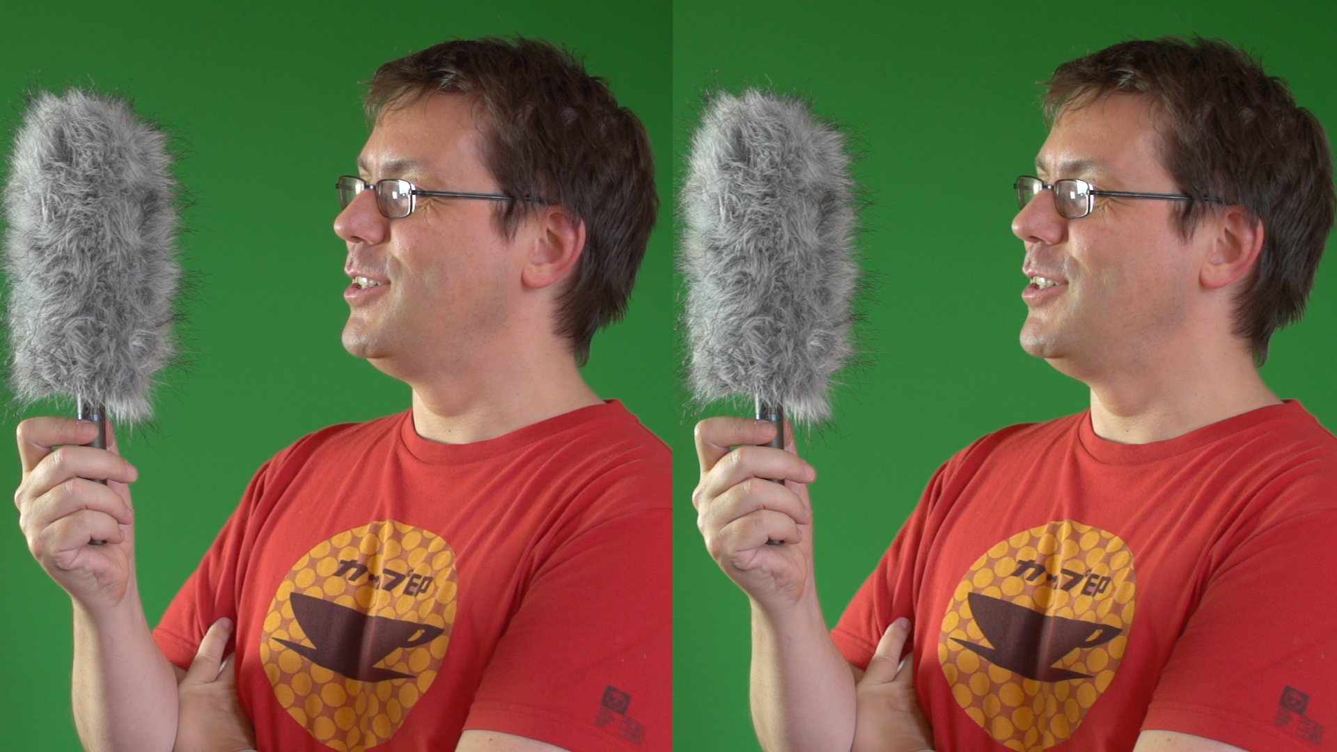

Here's a little test I did last year. The Alex on the left is the internal 4:2:0 recording using CG3, the Alex on the right is from what I recorded on my PIX220. This isn't a real shoot, just us larking around to see what we could break. FWIW, the FCPX chromakey settings are near-as-dammit identical (as it should be).
At the time, the FS700 was very, very new - I think there's a little bit of sharpening in the Picture Profile, which tends to add a thin black line round your edges, which 'eroding' the key does not fix in a nice way.
Is this the sort of key (nay, the sort of rushes) I'd expect to see on a pro shoot? NO! It was the sort of test that would show up where we'd have to spare more time (like a proper picture profile). Was it an easy key in FCPX? Hmmm - ask me another.
Am I happy with the FS700 for Chromakey? Compared to the FS100, hell yes. Compared to the EX1? Not really happy, I'd pick the EX1 over the FS100, and might even pick it over the FS700 if I had good lighting. Awful truth? The chromakeying software has a lot to play. I don't like the FCPX keyer, but my clients lack the budget to do a good job in After Effects.
