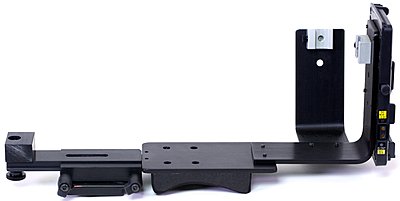

Yes it is a very good idea to support your long lens on the 700, especially if you are using a Metabones adapter or similar adapter.
This can be done with a 15mm rail system or a custom system.
If you use hard mounting ring on your matte box then you are supporting your lens if not then a separate lens support is the way to go.
I make both custom very compact solutions for this and also standard 15mm rail lens supports. I also make a Metabones support as part of my FS700 kit.

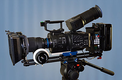

You would also need a means of balancing the entire rig, front to back, on the tripod head. The only way to do that effectively is to use a rail system.
Here's a shot of my rig. I have 6" extensions for the rails that can accept very long lenses.

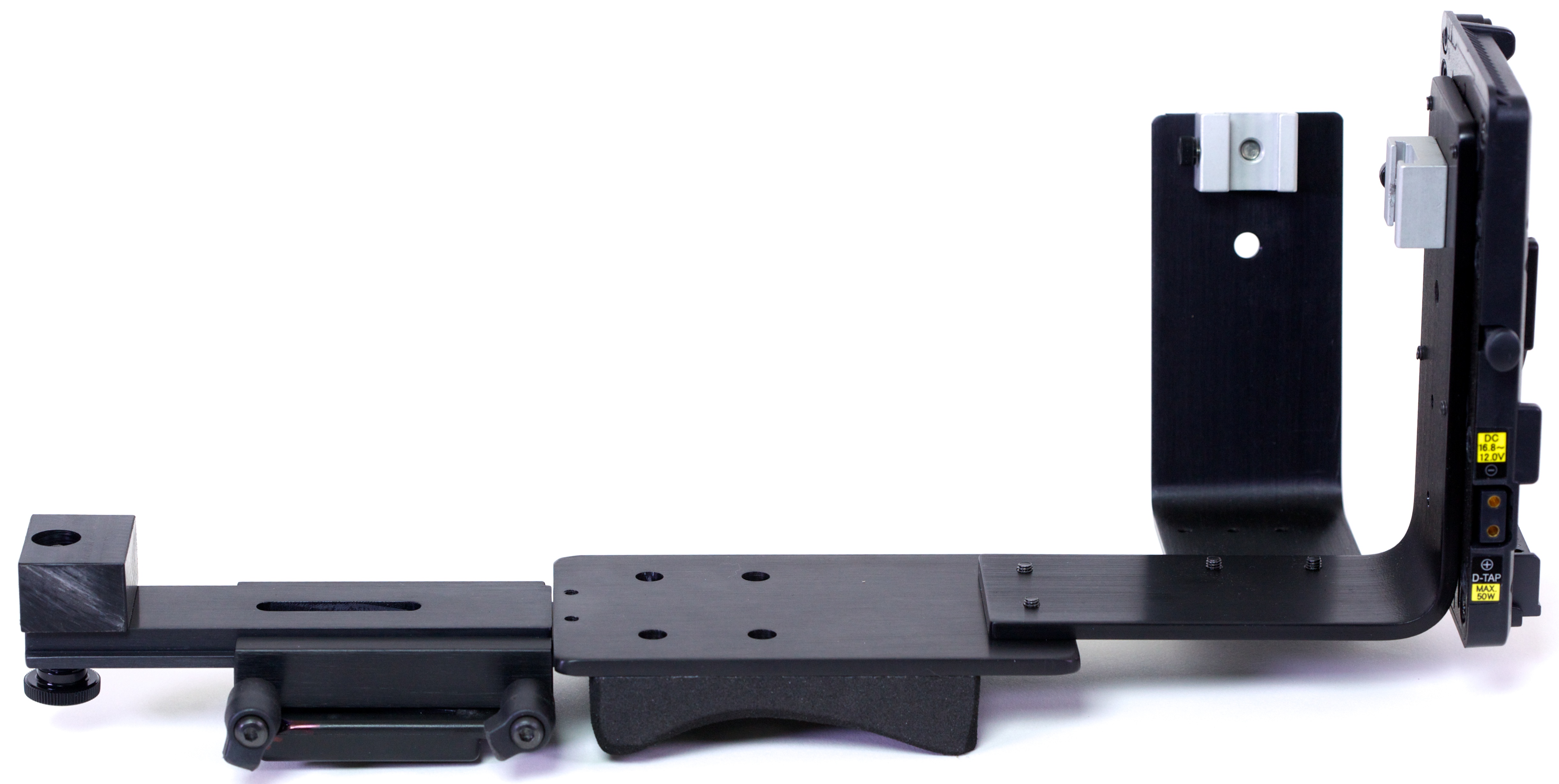

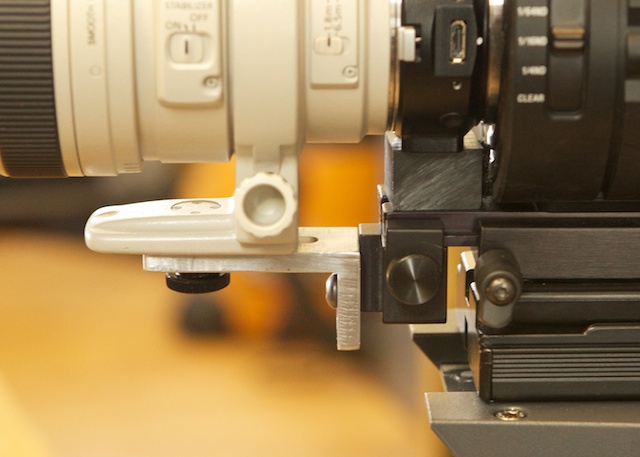

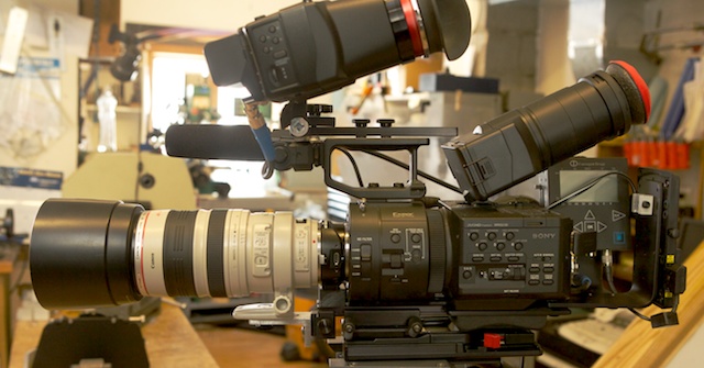

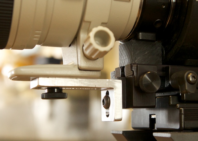

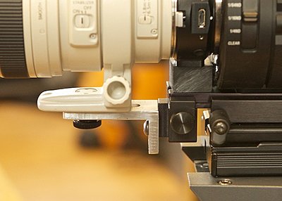

Here are photos of my rig. It is the standard 700 kit with the 15mm rail adapter, but instead of rails there is a simple adjustable angle plate that supports the lens.
If you actually use the 15mm rails there is a support for lenses that is part of my 15mm system and others as well. Or you can have the matte box support the end of the lens.
In these photos you can also see my Metabones support just in front of the camera. I make a variation of this for A lenses adapter as well.
I have also made special custom rigs for shooters that want to be able to adjust the head so it sits right in the CG on very large lenses. These are custom rigs based on my UniCamRail system. I will see if I have a photo of one of those somewhere as well.
