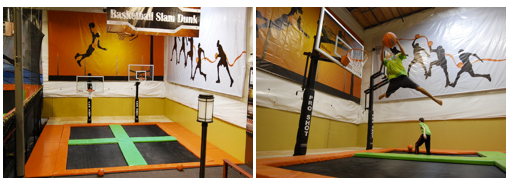

I'd also like to know outside of BCC plugin, is there any other flicker fixer for POST? Either latest Premiere Pro or FCP 7? Does AE have any helpful tricks?
Here's my issue - going to shoot soon at indoor place - 240fps, 480fps

If they are traditional "redheads" then they have a tungsten bulb, which will NOT cause any flicker. There is always the chance that you may get flicker with HMI, fluorescent, halogen or LED depending on the ballasts used. I personally will now only rent HMI sources with a 1000Hz "flicker-free" electronic ballast if any high speed shooting is expected. I've had good luck with professional grade LED sources which have a DC converter. Consumer LED sources that use AC and only light for half the cycle will definitely flicker.
At your location you will want to turn off the house lights which look like fluorescent. Your two 800w tungsten sources will not be enough to light that whole basketball court, but you could probably get away with just lighting the player and the basket and shooting at 3200 ISO.
