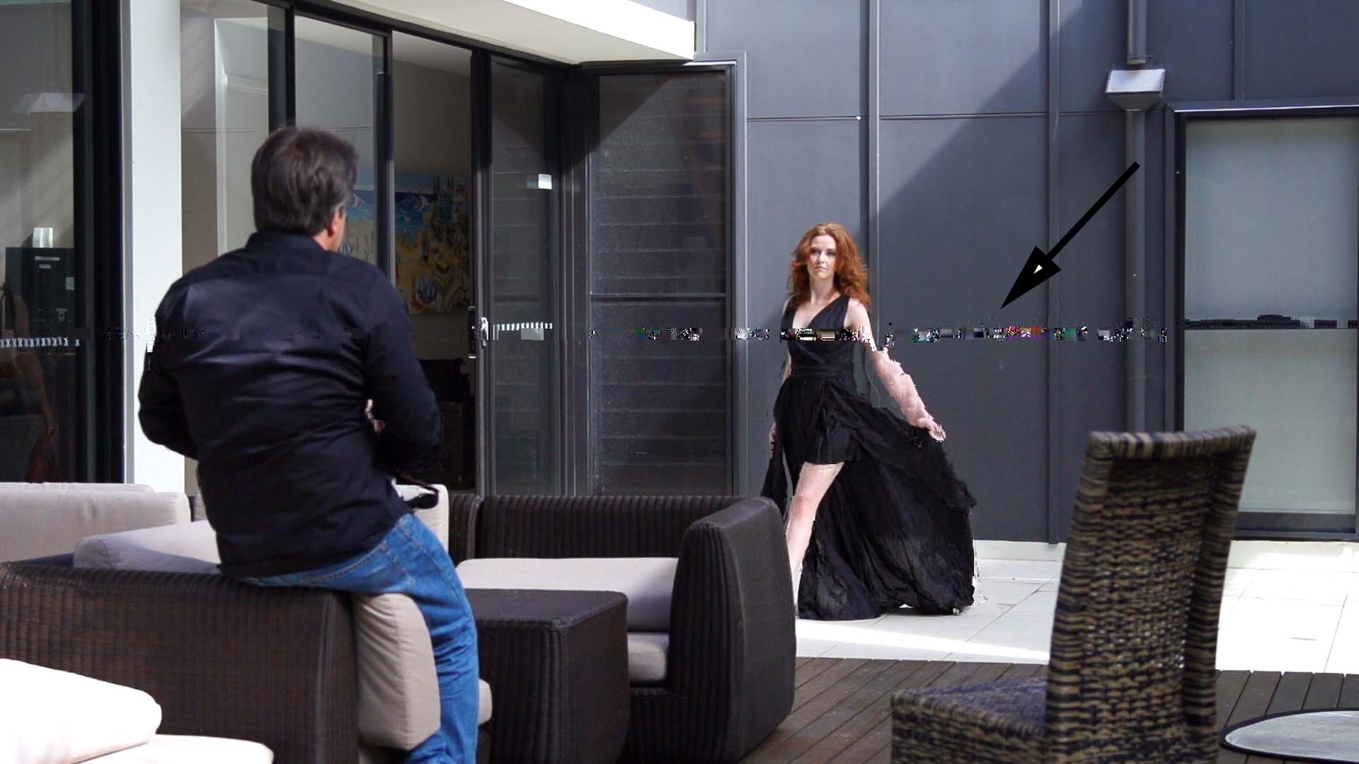

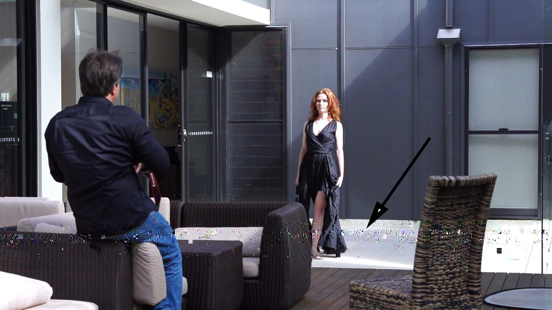

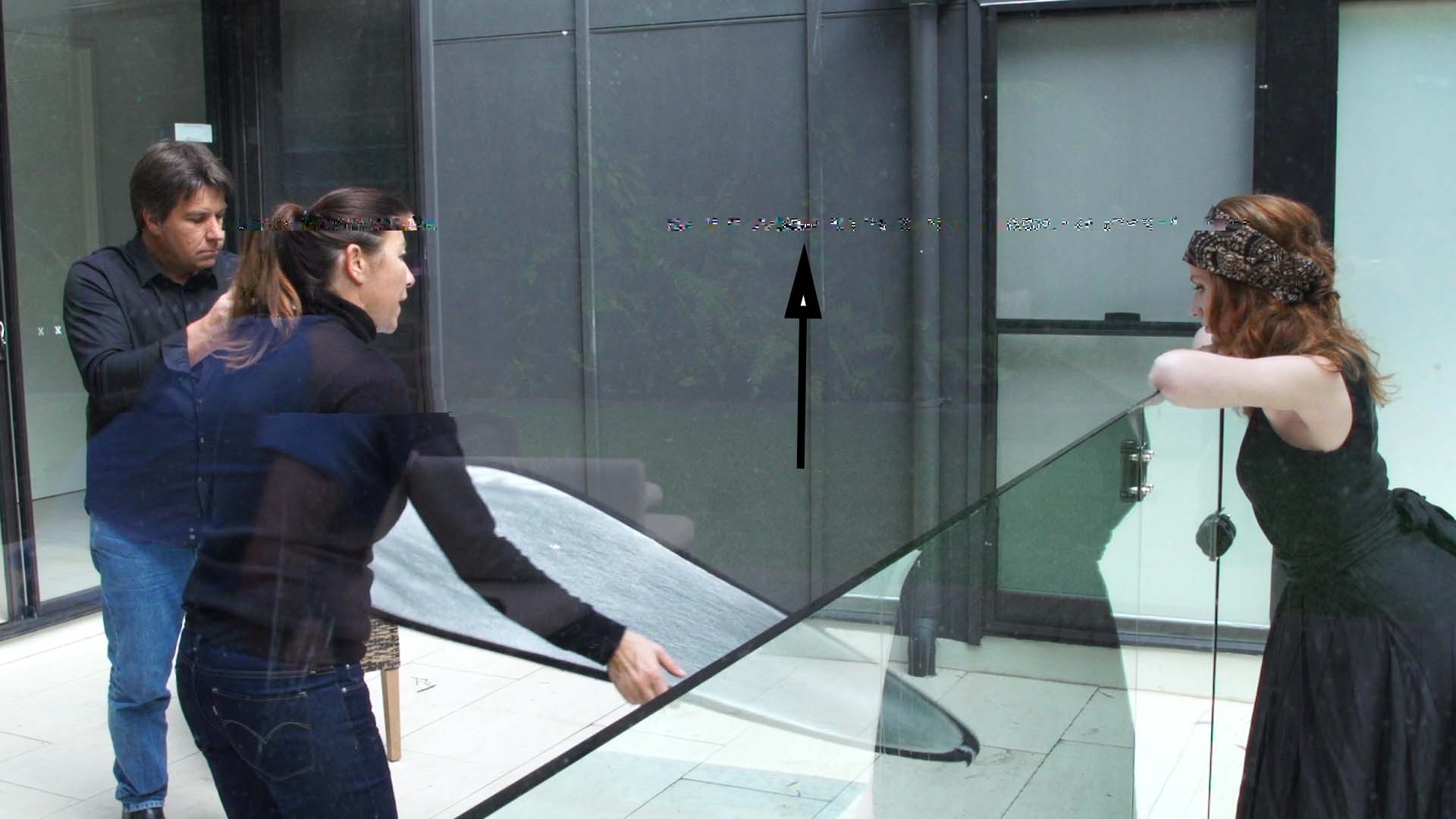

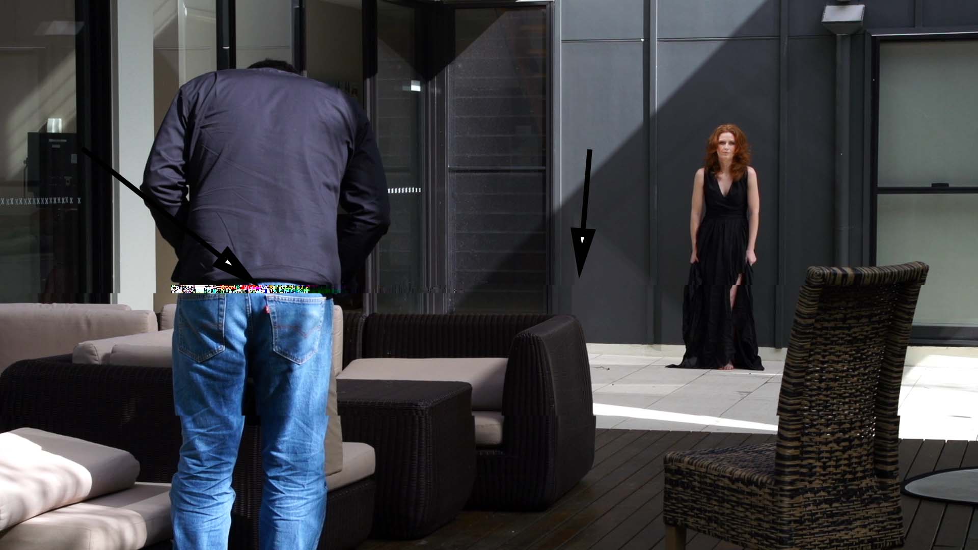

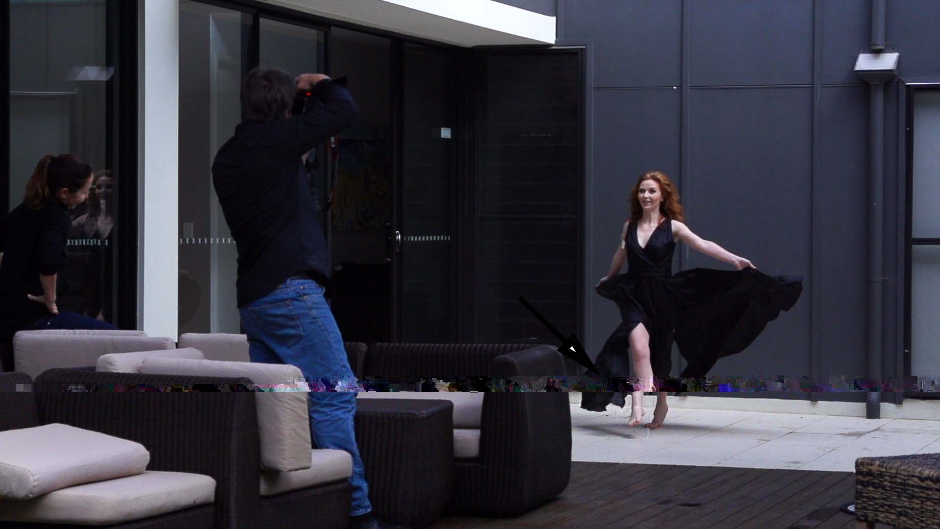

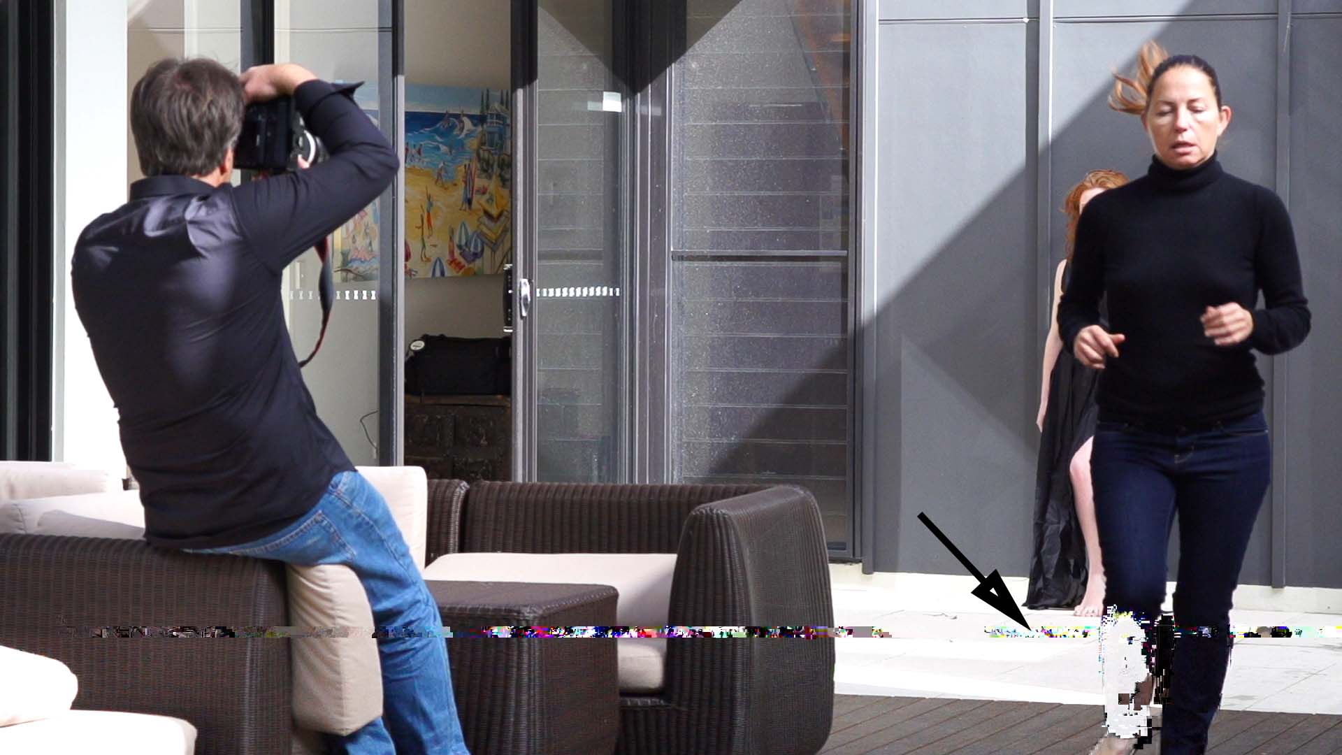

had the fs 700 for about nine months now, been great, but have just come back from a shoot and I have this "problem" with the footage, stills attached. had been shooting for about a week with no problems - this is the last part of the shoot and while not on all the shots from that day it was on about 6.. it runs for about 10 frames per shot and the shot were from about 10 sec to 45 sec long..
and ideas?

How full was the memory card?
What part of the file was corrupted? The beginning or the end? Was there any pattern?

Does look like a memory card failure/writing to card error. Was footage recorded to the same card or different ones?

card was not full, probably about 1/2 full there was no pattern to it at all, different places in all clips.....my initial thought was corrupt card, but I have not seen this type before... there was no warning in camera etc....will do some test records on card when we have a chance to see what happens.

Originally Posted by Greg Waite View Post
guys,
greg
I have seen corruption that looked like that with my EX1 when I was first experimenting with SD cards and adapters. I stopped having problems when I went to better cards.
That isn't to say that good cards can't have trouble. That looks exactly like the glitches that I would get on the EX1 when the card had trouble. I would work to eliminate the memory as the source of the problem first.

Card overheating for whatever reason.

From your post I gather you did not see this on set either on the camera LCD or external monitor? So, this must be an internal recording/card error as others have stated, not a sensor issue. Please keep us updated as to what you find out.
