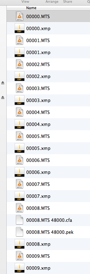

Thanks for the info - I did find the STREAM file, so can and DO I rename all clips in this folder and can I then drag these individual clips into new folders? If so, which files must I drag with each clip? Here's what I see: (see pic at bottom)
OR, is it impossible or bad to put into new folders because PP CC can't then read the clips if they're out of the AVCHD/BDMV/STREAM file structure?
Clipwrap yes, but just wondering if you have to do that, or can you just drag clips from the STREAM folder into new places? Probably not because of the structure needed?

Re: How to make individual files from the single AVCHD file
You can just drop the MTS clips directly on the timeline in Premiere Pro. They also play back OK in VLC, if you're just previewing. I use them as source files inside Episode Pro from time to time also (although you must specify the frame rate for them to render properly).

Thanks - yes I know I can use natively in PP CC but how if at all to drag them individually in another folder without Clipwrap -
Right-click on the Private archive, choose "Show Package Contents." Then the AVCHD archive, choose "Show Package Contents." Keep doing that until you find the STREAM folder. Drag the MTS clips out to another drive. Use those clips in Premeire Pro. Nothing more complicated about it than that, mate.
