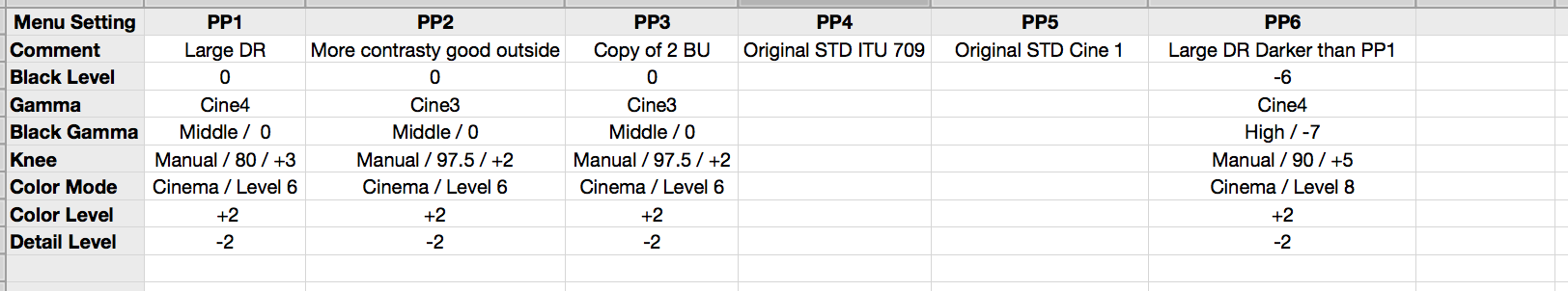

There are no hard and fast rules. It is up to you and your style of shooting/editing.
I came up with my PPs the same way I set up every new camera. I spent time playing with it while looking at scopes and eval monitor, under many different lighting (contrast) conditions.
I shoot for a decent look out of the camera w/o sacrificing DR.
These are the settings I use, PP2 and 3 are my standard goto settings, I have 2 copies so I can tweak one in the field if need be and then quickly go back:
