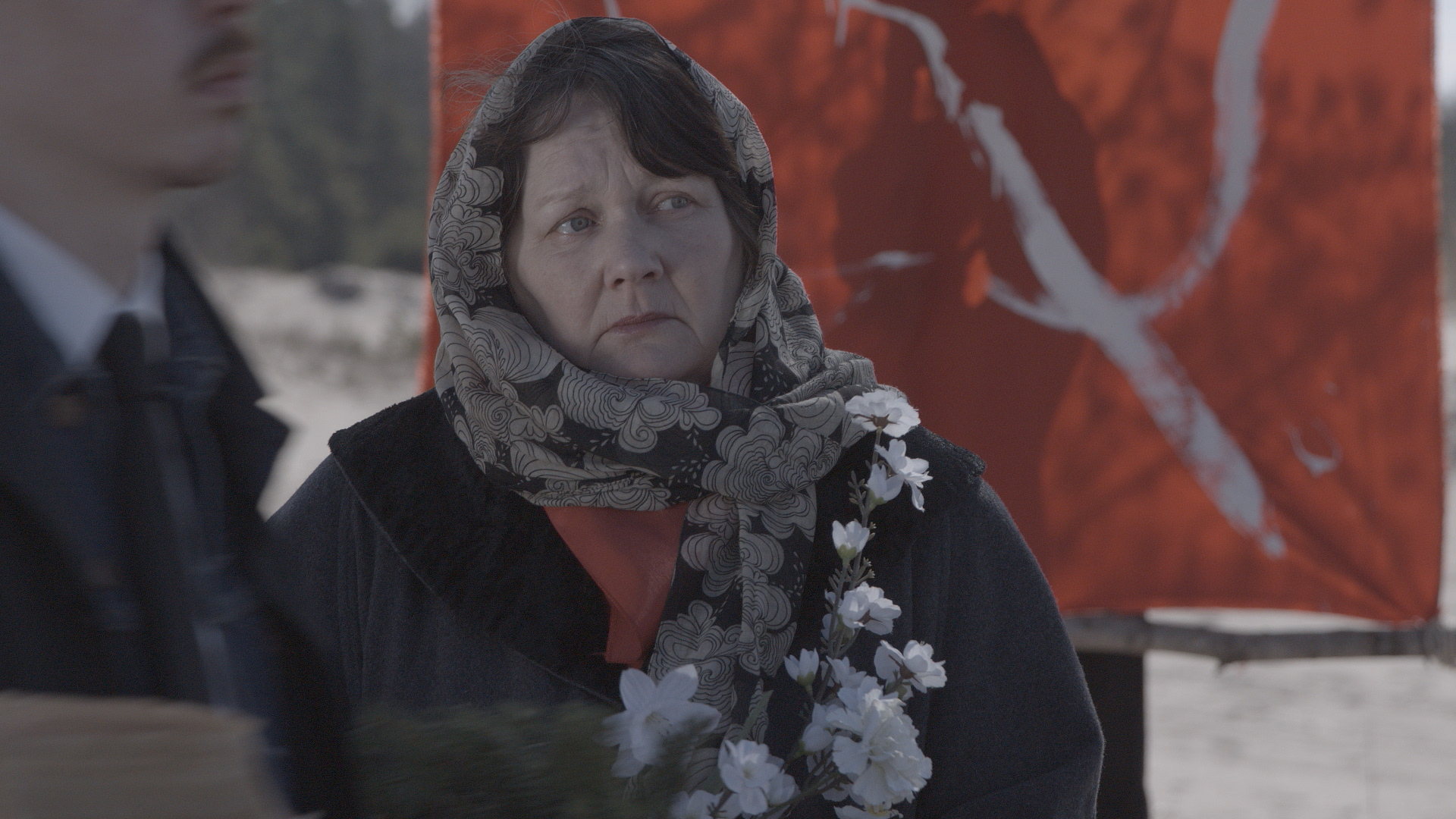

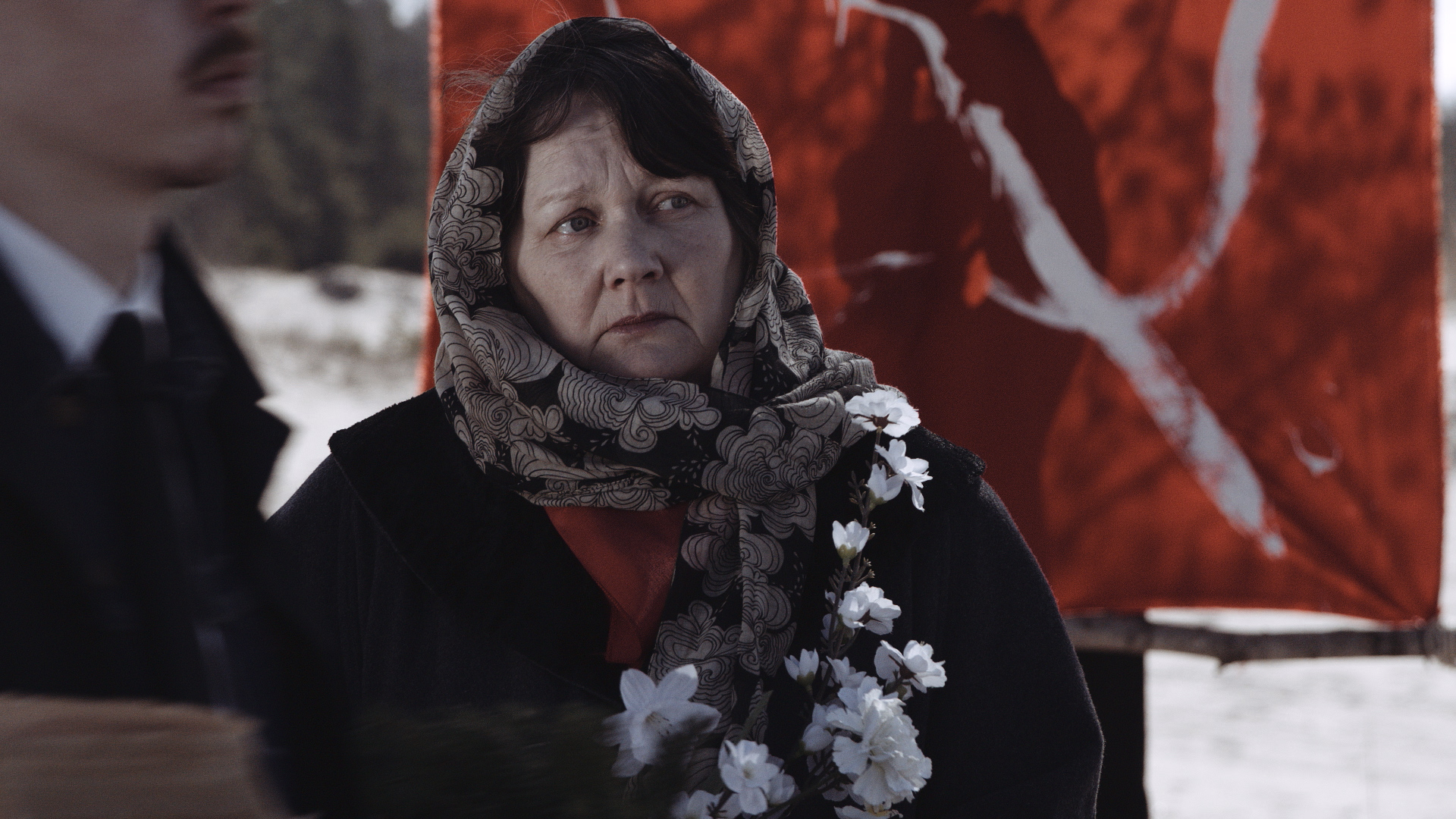

Here's examples from my recent shoot. First is ungraded shot with FS700 / O7Q (4K2HD) S-log2. Second is with a LUT by Filmconvert (made for Sony F55 but should be about the same as FS700 no?) with no further adjusting of curves.
Would you say the exposure is ok?
Sami

I would say your SLog2 is over exposed. Not by much, but definitely over exposed. If you apply the Sony Slog2 to 709(800) LUT to your frame grab it looks over exposed, the background on the verge of clipping and the womans face and flowers excessively bright.
Of course you may have chosen to over expose a little to reduce your noise footprint, but it's definitely exposed above the nominal "correct" exposure levels. The white flowers should be around 59%, yours are closer to 75%.

No this was purely me not knowing what I was doing in this case. :)
This was shot ND 1/64 and f5.6. I remember thinking that I'm slightly under exposed. I set it to Rec709 LUT on the O7Q and to my eye it looked as if the darks were about ok (but I wanted some room in the darks to be safe), the highs clipped a lot.
Lots of learning to do...

As I said it's not far off, just a little high. Exposing SLog2 correctly by eye is challenging as the image has low contrast so judging relative exposure levels can be tricky. This is where using a 709 LUT really helps as the normalised contrast makes exposure judgements easier.
