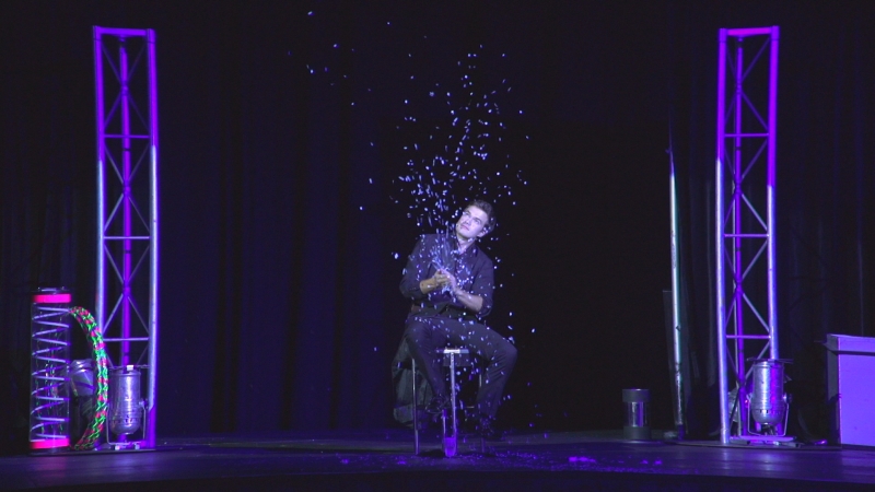

The BIG downer is the pronounced pincushion effect on full zoom. In fact it looks like it may have slight barrel distortion at the wide end. This you might just get away with but the pincushion on the long end means I won't be buying it. I believe, though haven't tried yet, is that on an NEX still camera with latest firmware it's not an issue as the still cameras have inbuilt software correction for these anomalies. Sadly no correction for the video camera end of the family.
Have attached a still of the long end pincusion. Didn't worry about the wide end as I felt that was pretty minimal barrel distortion but the long end, phew!

have you tried any post correction? in premiere using the lens distortion effect with some negative numbers can do some nice correction, and it's keyframable, so you could have it actively correct a zoom.
post a sample clip if you like and i'll correct it

Yes its correctable but would you want to correct every shot on a multicam two hour show? The time required alone to correct a single zoom shot let alone dozens and dozens of them that go from mild barrel distortion to pincushion would be totally unrealistic IMHO.
Will be interesting to see if Sony can come up with a firmware solution.
