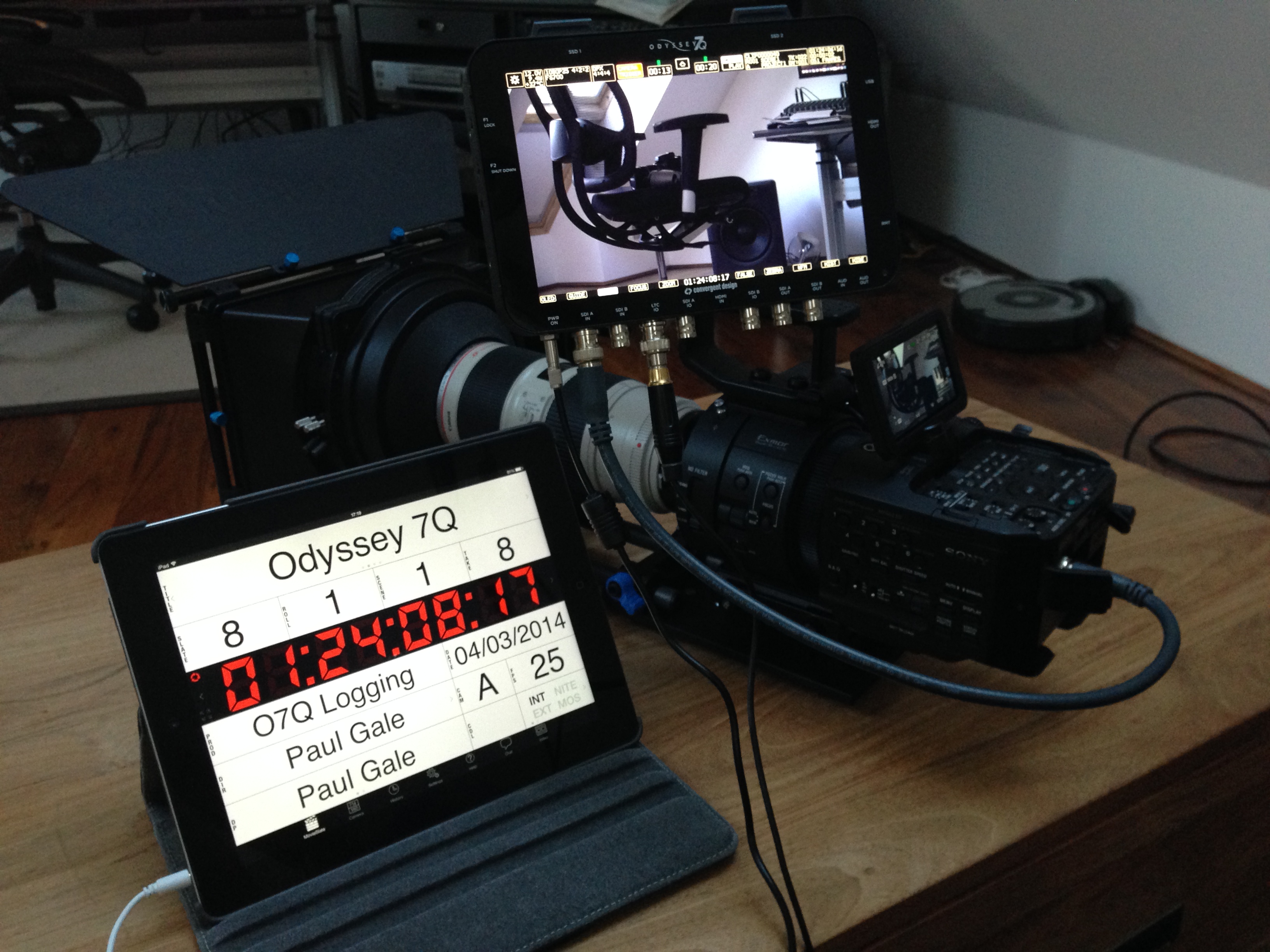

I just got around to trying the TC out - and was very surprised to see that it actually does work now, without the next firmware update.
Have a look at the attached image - shows the O7Q feeding MovieSlate on the iPad.
Works really well with one technical issue - when the camera is in the paused mode, the O7Q seems to output either nothing or 00:00:00:00. I think it should be outputting the same TC as is shown on the screen.
Dan - I'll submit this to tech support too.
It is useable though. Wonder what he actual changes are for the next firmware?
Paul.
