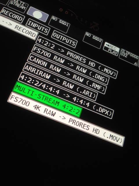

This is what the menu looks like immediately after the firmware update. We will be conducting a full barrage of tests tomorrow.
Attachment 32174
I'm actually most excited about the 4K RAW to ProRes 4:2:2 (HQ) at 1080p. 4K as DNG is there for the future (or short projects,) but 10-bit ProRes at 1080p is what will serve my clients now (long-form doc and music video.) I'm tired of being bitten in post by 8-bit processing.
