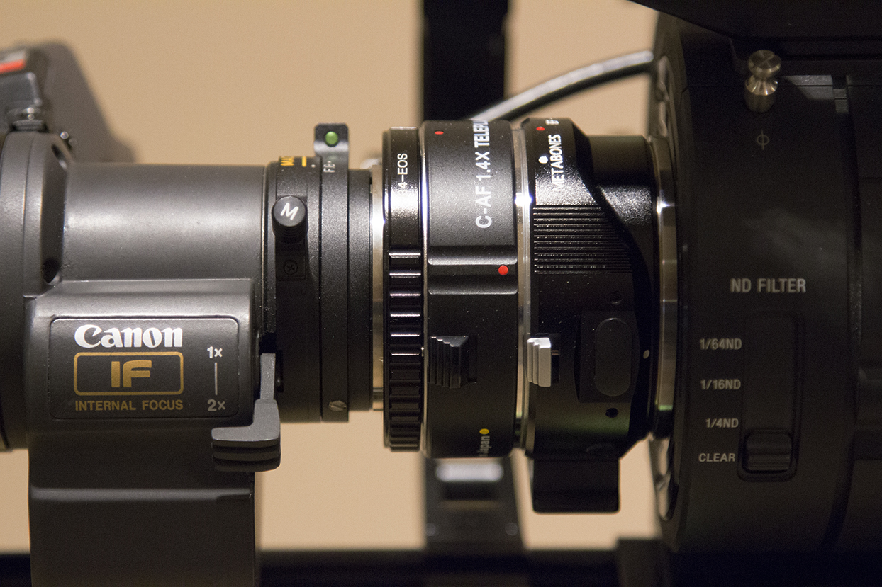

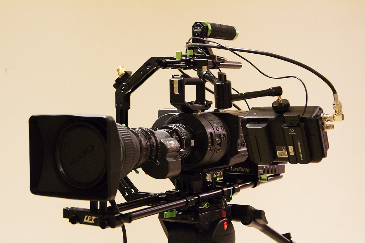

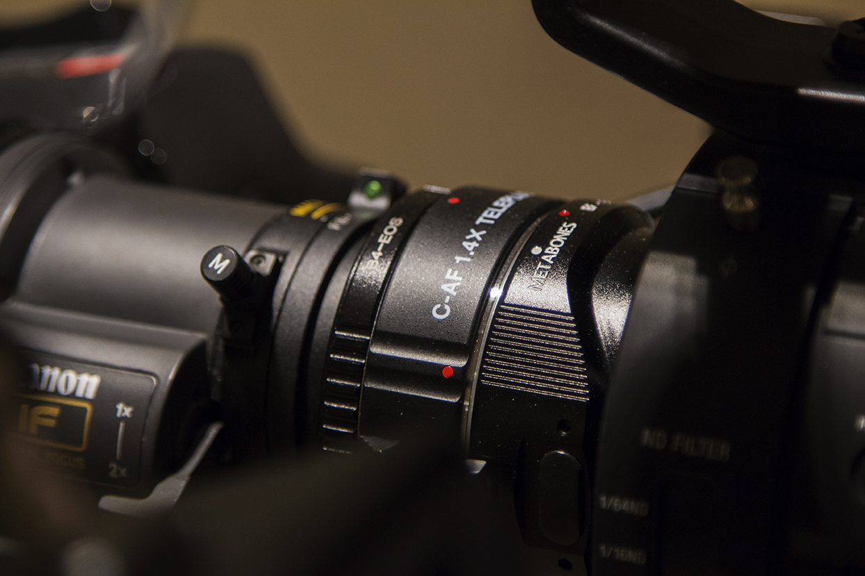

I have a Canon lens on my FS700. It is SD glass, but is pretty sharp at ~F6 and higher. I have the lens' 2x doubler engaged. It is attached to a B4->EF adapter, then to a Kenko 1.4x tele-extender to prevent vignetting, and finally to a Metabones EF->Sony E Smart adapter functioning only as a 'dumb' adapter.
nex 700 with fujinon lens-full-rig1.jpg   nex 700 with fujinon lens-full-rig7.jpg
