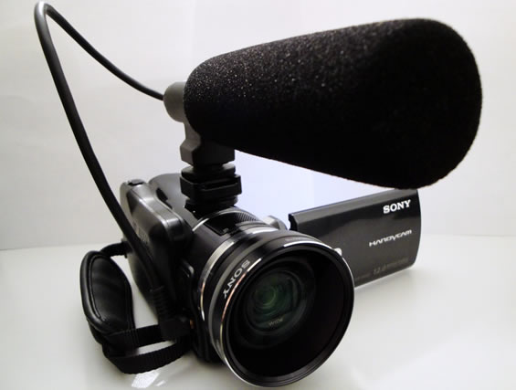

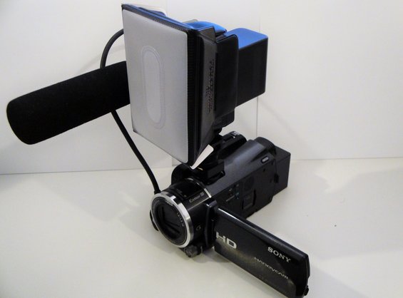

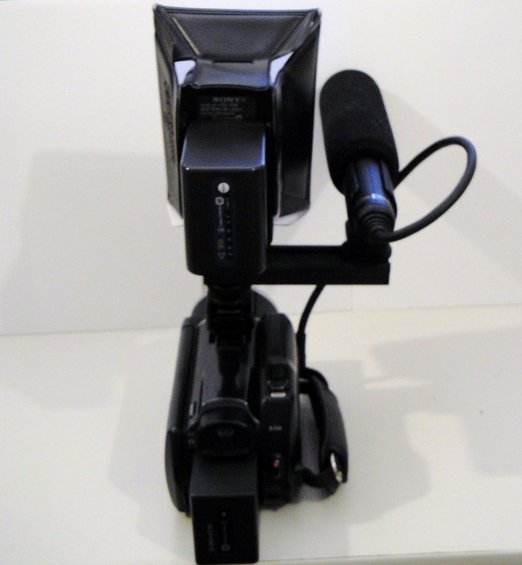

I use the single shoe version of the cube above to mount my mic, when I need to mount a light also I add a Rycote 4" bar to that.
AISFLAT Adorama Universal Cold Shoe Adapter for Sony Type AIS (Active Interface Shoe) Hot Shoe (FLAT TYPE)
037303 Rycote 4", 100mm, Accessory Shoe Extension Bar, Allows Mounting Two Shoe Mount Items.

A couple quick comments - the Bescor, which is also available under the Sima brand and probably a few others, has an awkward short lower spar and angled vertical, making it less than desirable since it won't get past the big 3.5" LCD on the 550. There have been a FEW dual shoe brackets that have longer bars, but they are hard to find and I believe out of production.
I've got a "perfect" bracket I picked up on eBay from a guy in the UK, never seen another like it before or since, and no markings to ID it! I'm sure if I post a pic, someone in China will take measurements and one will be available in no time...
As for the strength of the shoe - it's metal in the Sonys, and directly attached via screws to the underlying metal skeleton of the camera - if you break it, you're buying a new camera anyway... at least from the perspective of someone who's looked under the skin. I'm sure not all cameras are as sturdy, but the offset bracket Matt posted probably would be fine. I've got some cheap Chinese single shoe adapters coming in for under $10, I'll see how they are, but should be adequate for a single mount, plus I have some odd old shoe adapters hanging around.
It's sort of a tradeoff - if you don't use the AiShoe, an adapter there makes some sense, but if you're going handheld, a good bracket helps stabilize your shooting, so has its own attractive purposes.

Re: video bracket for cx550
Originally Posted by Wayne Reimer View Post
The only thing that makes me nervous with shoe mounts is weight. They aren't very sturdy on many ( most) cases, and I've seen nothing more than a large flash unit tear them right off of a camera. When you tip the camera off-axis and return it to normal orientation quickly, you set up a fulcrum point at the weakest part of the link; the shoe.
The weakest point on my setup would be the cold shoe mounts on the light and mic as they're both plastic. For what it's worth I've held the camera vertical and shook it with the light and (NP-QM91D) battery and it seemed to hold up just fine.
