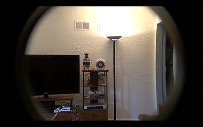

One thing to be aware of - you probably will run into pretty serious vignette when mounting a tele on this camera - the stock lens i so wide, you'll find that you'll be looking at the innards of the tele lens until you zoom in a significant amount.

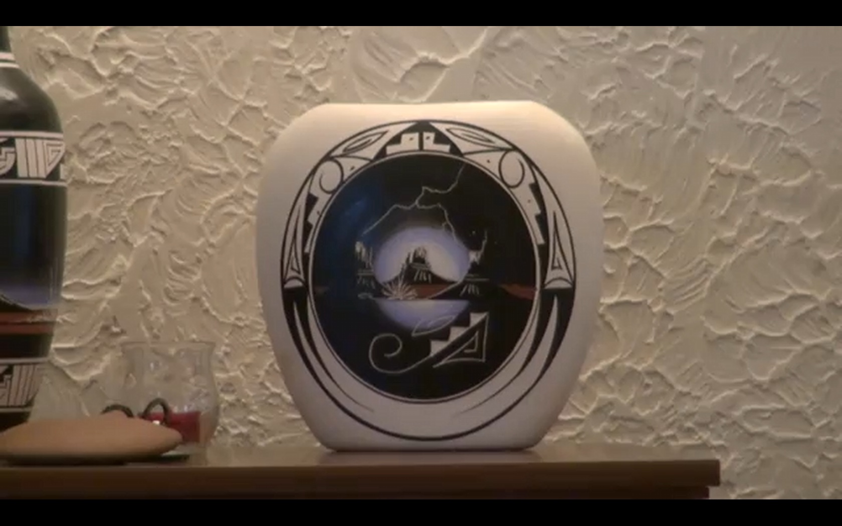

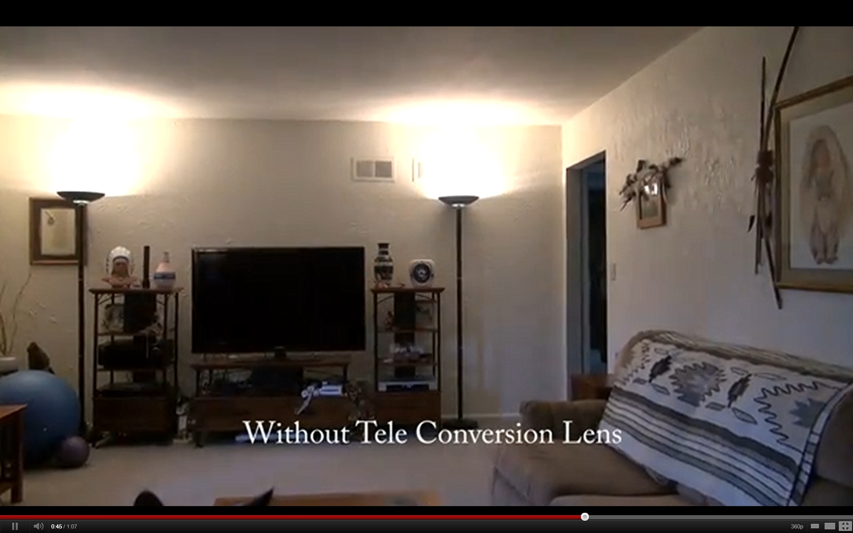

Dave is correct, I took the liberty of taking some screenshots from the following video of the HG1737C on a CX700V (same lens/sensor as the 560): SONY VCL-HG1737C Tele Conversion Lens on Sony HDR-CX700V - YouTube
Which telephoto lens for a Sony CX560V-without-tight.jpg   Which telephoto lens for a Sony CX560V-without-wide.jpg
Which telephoto lens for a Sony CX560V-tight.jpg   Which telephoto lens for a Sony CX560V-wide.jpg

Matt's screen caps pretty much tell the story though.
