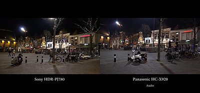

A few of us on here have picked ourselves up the Sony CX730 over the years. But they are near impossible to pick up anymore. Currently only one I can find is an ebay auction from Latvia… Auctions will probably see them sell at high values since theres now supply and high demand.
I’ve been looking for what alternatives there are out there. (Its difficult - most people who use this level of video camera are not overly concerned with low light)

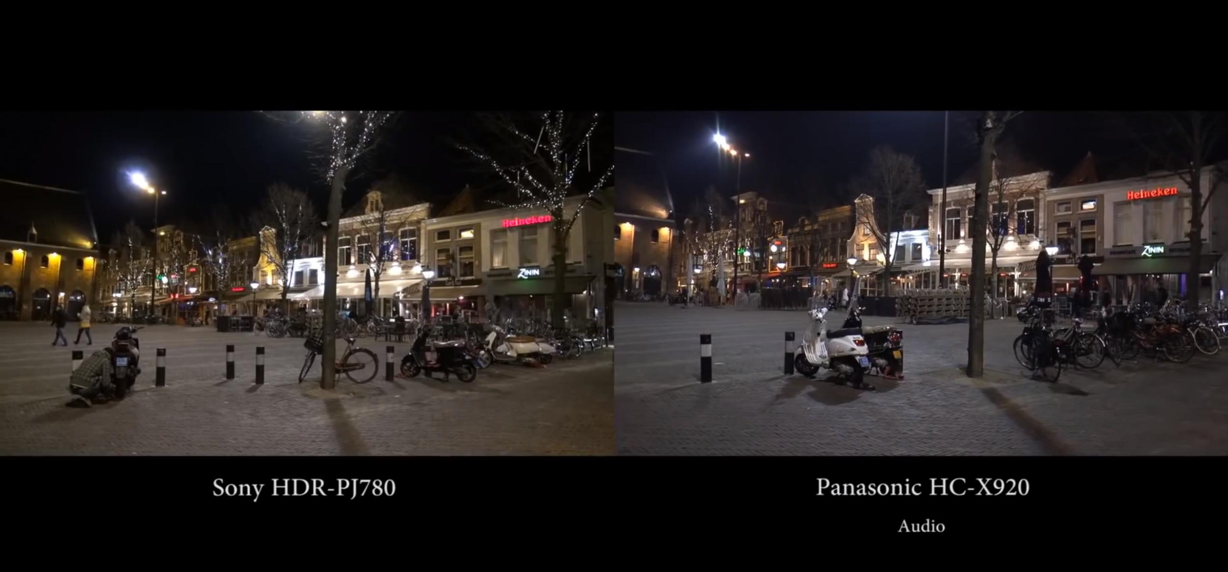

I’ve attached a side by side shot of a low light comparison between the Sony HDR-PJ780 and the Panasonic HC-X920.
To me the Sony doesn’t cope with the colours well - the yellows are very saturated and don’t look pleasant and the red in the heineken sign looks poor. Perhaps its pulling more light out (slightly) but at a cost.
The key thing is, the Panny here is a good few hundred cheaper. I’d be tempted.
Thoughts?

The Sony has had a lot of good coverage on here, partly I seem to recall because of Noa's positive experiences.
But at the same time many of us have been using the Panasonic X920's predecessors - the TM900 and TM700 with great success.
The images you've linked to appear to show the X920 does a better job than the Sony - though obviously there can be lots of variables and subject to the reviewers technical ability.
Why not get an X920 from Amazon and give it a quick low light whirl? Their returns policy is very forgiving and a "didn't perform as expected" selection reason - which would of course be valid - would not involve you in any net expense at all.

If I had to replace one of my sonys I probably would go for the panny, not sure how it's low light performance is but I have seen enough samples to know it provides a sharper image (you can see it as well in the side by side images), my sony had a much sharper image then my canon 550d but my panasonic gh3 is yet one level above my cx730 in terms of resolution and it looks this is an area most panasonic camera's excel in. The sony standard image is a little bit flat where panasonic camera's often have more punch to their colors, however I find the sony image easy to match up with my other camera's as it's flat image is easier to color correct. I would keep at least one sony handicam, mainly because it's very wide angle lens which has been very valuable in cramped spaces and the latest sony cx model seems to have a very good build in microphone which is less the case with the cx730.
I"m sure that paired with my panasonic gh3/g6 the panasonic handicams would probably be the best combination resolution and colorwise but my sony's will have to do for some time as I already went over my budget last year with some investments I made :).
