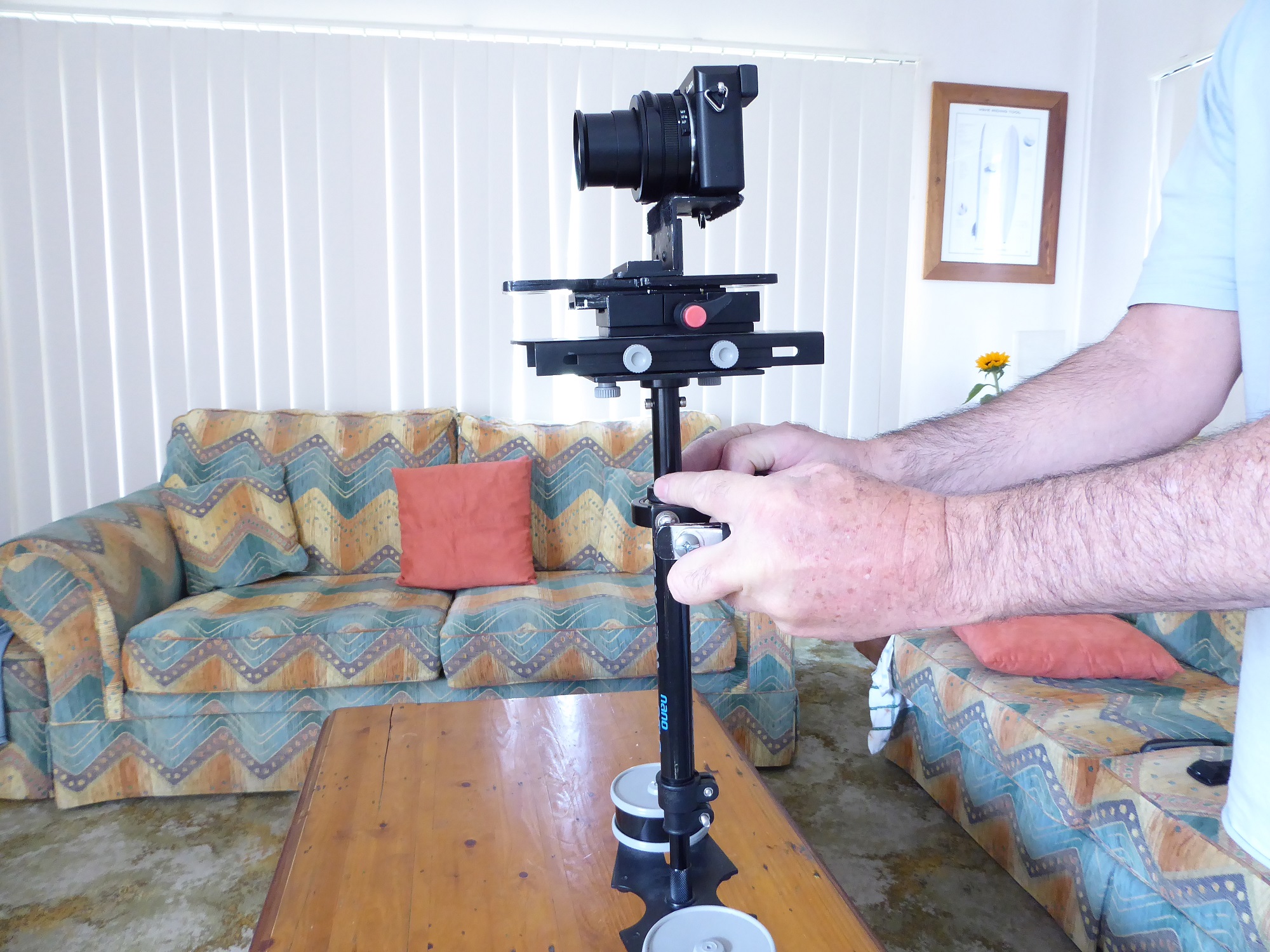

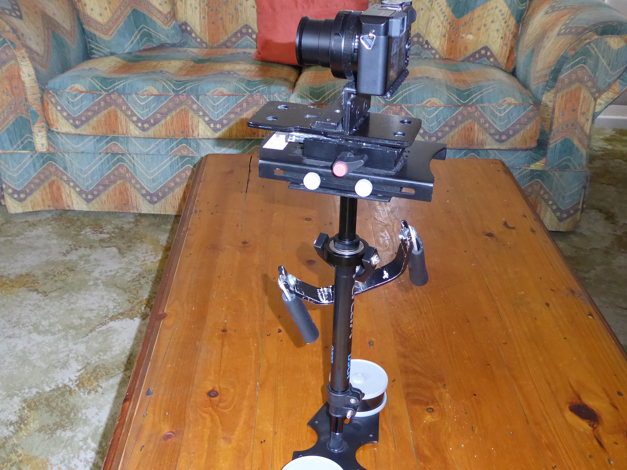

I use an el cheapo Flycam stabilizer to fly my LX100. I leave it permanantly attached.
won't work without added weight to the baseplate though. Works very well for what I do, wedding video.
I've rigged it with two handles, and use my index fingers to steer. Gets very steady footage whilst wandering amongst guests during reception and on the dance floor.

Hi Erick, I also used it with the 70D 11-16 combo, worked a treat.. Gone full Panasonic now. GH4s, FZ1000s, and a couple of LX100s, one of which sits permanently on the "Flycam Nano" I've got a 6mm steel plate on top of the sliding QR plate and jacked the camera up higher with an S shaped bracket I made to help me get to the battery door without removing the camera from the little rig.

Here you go Erick, had to resize these pics!!!!

your steadicam looks good Jack. Is the "T" design better than the "C" design in steadicams? The Blackbird is almost a T style but kind of big. I was thinking of getting a compact 'steadicam" for the RX100 IV (and a Go pro hero 3 black) for some shots in weddings and live events-easier to fly than the 70D-but if I get better results with the Blackbird after adding a Manfrotto quick release plate at the top so that the RX100 is heavier then maybe I should stay with that set up. I guess the only way to know would be to test it.

Cheapest would be to just add some weight to the topplate that holds the camera so you can fly the rx100, the blackbird is a great stabilizer (I have one) and it will be difficult to find a much smaller setup that will operate as smooth.
I'd have to agree with Noa. Tried some smaller stabilisers that were designed for compact cameras, useless, not enough weight to allow the bearings to operate smoothly.
