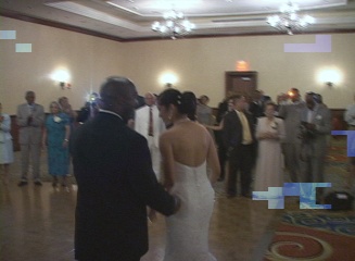

Can someone tell me if this is a bad tape or something wrong with my vx2100? It only happen 2 times during the wedding and reception.

looks like you're recording on a "used" tape - and the prior recording is "bleeding through" on some pixel blocks - saw that a few times with my older TRV's. Probably wouldn't happen with fresh tapes, probably not technically anything "wrong" with either your tape or camera per se.

could have been a bit of 'gunk' on the heads and it came off while the tape was rolling. I get this on occassion and run a head cleaner thru. Only every once in a while though.

Dave, I always use new tapes. It only happen 2 times and for only for a split second. Maybe Don is right, the only thing is I had just used a cleaning tape a couple of days earlier. I just hope its not the Camera

I doubt it's the camera. My PD150 is over 8 yeaars old, has more hours on it than I can count but 2 or was it 3 years ago I had the heads and transport mech replaced. My 170 is 3 or 4 years old now and has a whole lot of hours since it's my primary camera and like I said every once in a while I get a dropout like that. It COULD just be THAT particular tape OR a bit of yuck on the heads. Even though you ran a cleaner tape you MIGHT want to do it again but remember to follow the directions to the letter. I think most of them say something like no more than 10 seconds at a time. Once more should do it. Sometimes the stuff just doesn't come off the first time.
I wouldn't worry too much about the camera.

Just a follow-up. I found the reason for the bad video. After I shoot a wedding I play the tape in a small sony videocamera to get it on my PC. I also play all our church sermons on this same camera. Those heads were very dirty, so dirty I can't clean them. I used another camera and it worked prefect. By the way, what do you use to tranfer video to your computer?
