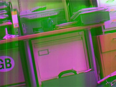

I had the same problem with a DSR-250. My service guy rang Sony and they sent a courier with a special packing case, shipped the whole lot to Belgium, replaced the CCD block and I had the camera back within 10 days. I've posted a grab of the fault. The camera was about 3 years old, I had no extended warranty and paid nothing.
Hope this helps

That's it Graham!.. but in red.
