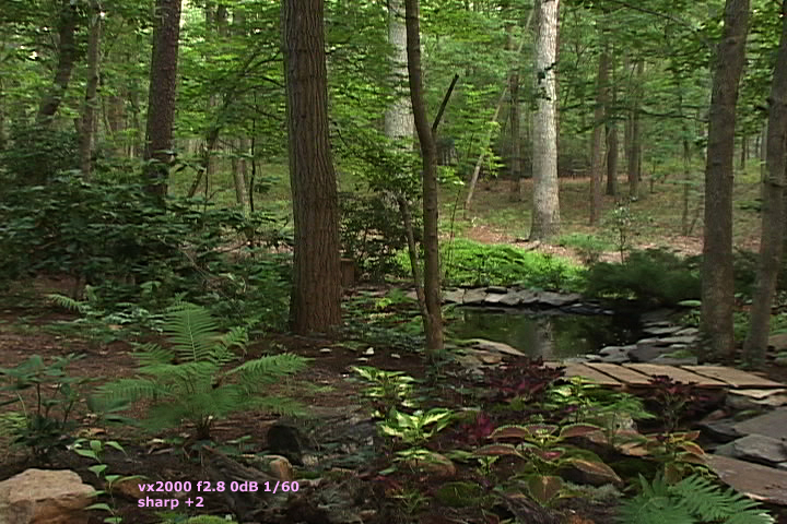

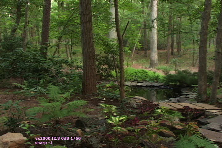

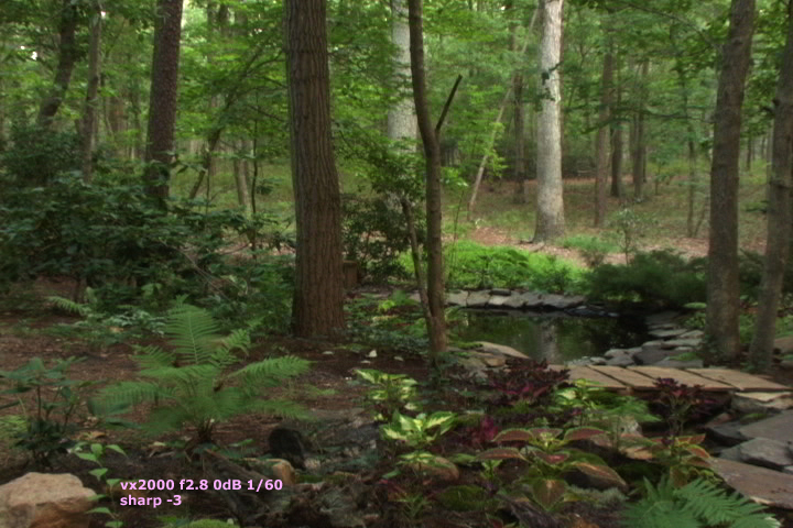

I'm currently using a Panasonic AG-DVC30 camera and thinking of replacing it with a VX2100. From what I've gathered, the 1/3" CCDs of the VX will likely give me better detail and increased low-light performance. All this is good. But I'm worried that the VX won't give me as "warm" a picture as my DVC30, especially when I have the latter in the "MovieMode" setting.
Does anything think this a reasonable concern? I shoot a TV show with a theme of old fashioned living, and I like the softness I can get out of the Panasonic; it seems to match the idea of the show. Is the Sony too "sharp"? If it is by default, is it just a matter of decreasing the sharpness? Does the VX have a movie-like setting? I'm not really keen, especially with my older Powerbook, of adding this effect in post.
I should also mention that my very first camera was a Sony Hi8 and it was built like a tank, never malfunctioned for a second, and was nice to operate. After a year with the DVC I'm still not very comfortable with it and find myself pining for my Sony setup. But I like the look of the DVC30 footage.
Thoughts, anyone? How would you describe the look of Panasonic compared with Sony?

You can certainly bring down the sharpness in the custom preset option (I presume the VX has this, I run a PD and can never remember which bits are shared and which bits are 'special' :) ), there's a few different options in there where you can warm up the whitebalance etc too, which might help you.

Yes, the VX and PD have the same sharpness controls. Several years ago I shot a series of tests at each setting (see below). I guess I understand where you're coming from by saying "soft" if you want to avoid the artificial edge enhancement typical of video cameras. But of course film is really much sharper than standard definition video. "Soft" is probably a bad choice of words since it's also a term used to describe an image which is out of focus.

Thanks James and Boyd. Very useful information.
