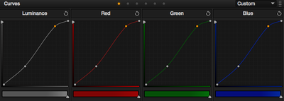

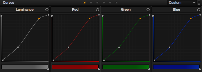

Hey Josselin,
I had a really long post that was kind of boring...but the short story is the "flat" from the raw is log encoded and is intended for a LUT or reverse gamma curve to be applied.
The curve I applied below is probably a touch too aggressive, but it illustrates the point. Sony raw to SLOG2 needs reverse gamma applied :-)
One of the first short shot with F55 !-screen-shot-2013-04-04-10.42.22-pm.png   One of the first short shot with F55 !-screen-shot-2013-04-04-10.37.38-pm.png

Originally Posted by Josselin Billot View Post
Thanks Nate for the sample. It's pretty good but it's doesn't exactly fit the story. The colors are great but the director wants something warm for the party. But I appreciate your work ;)
Oh man, it wasn't work. Just screwing around. :-)
You know like me dop can't made everything they want's with color grading, they have to respect the story and try to help it.
Of course. I just was trying to bring attention to the statement where you said "we didn't touch the middle".
It's intended to be touched :-). The grade I applied is immaterial, pretty much. One choice of many.
What I'm talking about is making the effort to halfway linearize the midtones of the camera, to put it on equal footing with Red and the Blackmagic camera. You agree Red and BMCC have a different "look"? That's what I'm talking about. Red and BMCC do these things automatically for you, Sony does not. I think it's important, I just want to draw attention to the issue in case you think it's important too.
It would have been possible for me to straighten out the midtone gamma and still have a low-con look. Or any look that suits the story.
