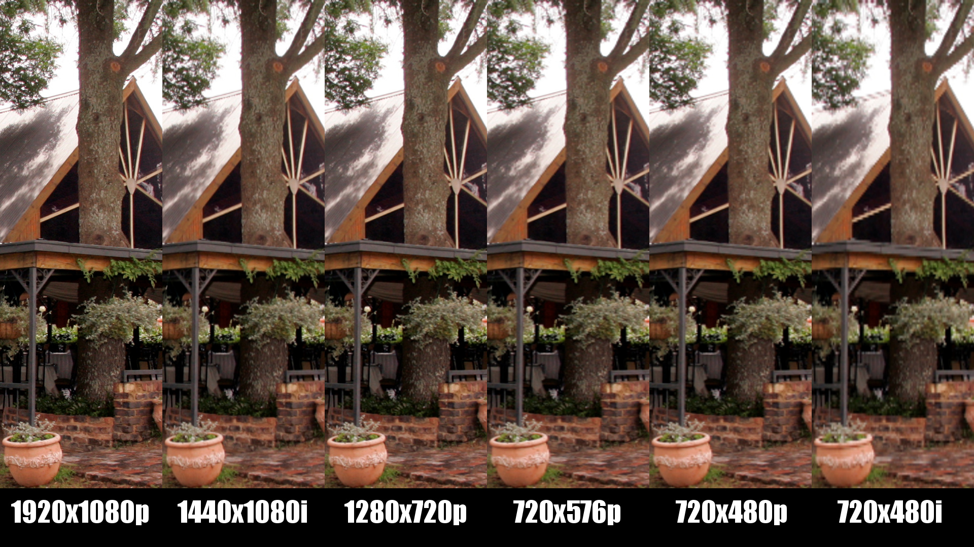

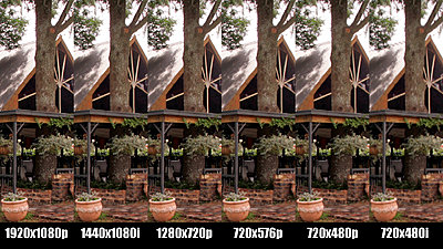

Ok, and sorry I do not agree at all. A lot of people enjoy 720p broadcasts and have never once complained watching shows in HD on ABC or FOX. I'm talking about film source shows as well such as Grey's Anatomy and other drama shows.
Here is a image I made exactly like you said I should test it. I took a Canon D20 still image and cropped it at 1920x1080 pixels. I then down scaled a 720p version and scaled it back up. I faked a 1080i version by adding in a slight softness for reducing the interlace flicker and low pass filtering. Sure maybe true 1080p when watched as true 1080p is sharper but it is not "clearly" better and only tech heads watching it on a computer monitor would ever notice.
This image does not give any numbers at all because I do not use numbers. I use my eyes and my eyes tell me that at the end of the day there is very little difference between 1080i and 720p. If you have a better example please show me because no matter what type of images I start with be it 3D rendered, digital still or actual 1080i still shots from HDV I find always the same to be true. It isn't exactly fair to compare 720p from DVCPROHD tape either since it only uses 960x720 pixels. We are talking true 1280x720 pixels.
