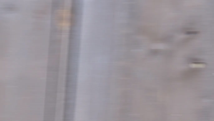

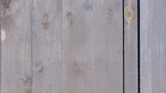

When using shutter speed at 50 and shooting in 720/25p I can confirm the the rolling shutter effect is quite apparent if you go out of your way to make it happen. I pointed the EX at a fence panel and panned rapidly back and forth, the result was the the vetical posts seem to bend slightly away from the direction of the camera. I haven't noticed it yet with normal shooting. There are loads of shutter options on this camera though, not only can you set speed settings, but you can define the shutter parameters using another three methods so it may be possible to reduce the effect.
Personally I didn't find it that much of a problem, it kind of mimics what happens if you pan your head fast too and almost enhances the sense of motion. When would this be a problem during normal shooting to the point that it would be noticeable?

It reminds of the effect you get when you put a pen between your fingers and wobble it from side to side making the pen look like it's bending.
Here's a couple of grabs. As I said though, this may be due to a setting I was using or it might be possible to reduce the effect by changing settings.

Paul, thanks for the images.
How did you perform this experiment, holding the camera and moving side to side, or was it on a tripod?
If you believe you stayed on axis, there's no doubt it's there.
Will it be a problem with normal shooting, I seriously doubt it. But, it may be a concern for some.
