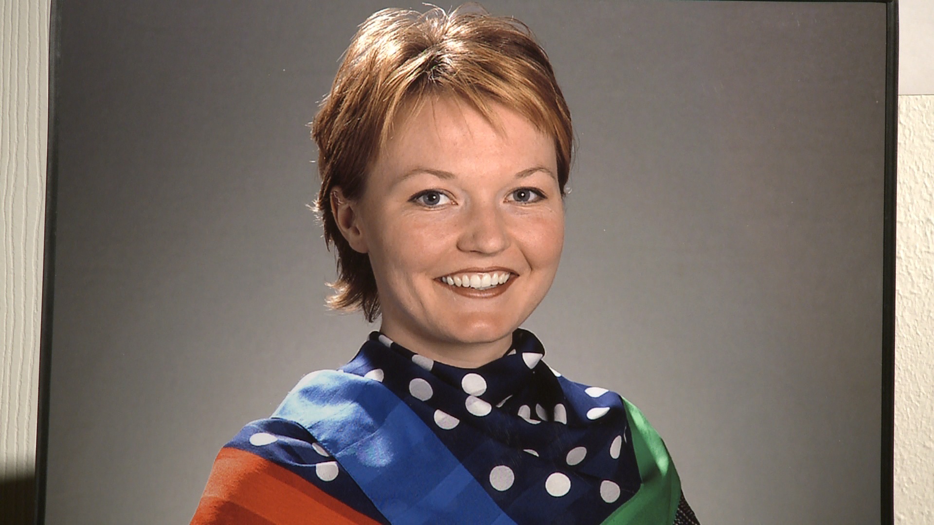

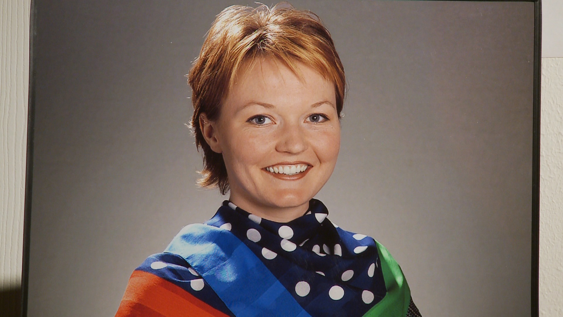

I've done an initial test with Picture Profile settings somewhat different from the Standard setting with which the camera is delivered.
The first frame grab is with the Standard settings. The second grab is with the settings that are different from Standard shown below. The Standard values are in parentheses.
PICTURE PROFILE "TEST 1"
-Matrix
--Setting ON (OFF)
--Select HIGH SAT (STANDARD)
--Level +25 (0)
--Phase +10 (0)
The test image used is from dsclabs.com.
I personally like the slightly more saturated, warmer image on the right...but everyone has their own preferences. When the rain in Tucson stops I'll get some video using the setups.

Carrol, did you forget the to attach the rez file?
Also, I like the look of your profile.
The skin has more of a natural flat look to it.
