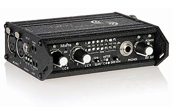

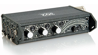

Old December 3rd, 2007, 06:37 AM   #11
Posts: 1,414
Might as well start working on this now.... if you want good audio it seems
that a good mike or set of mikes is going to be required and a mixer with
limiters and such.....
Here's two I'm looking at:
Sound Devices 302
and
Sound Devices Mixpre
Old December 3rd, 2007, 07:23 AM   #12
Location: Kelkheim, Germany
Posts: 375
Ray, theses are fine pieces, I own a 702 myself. But - beeing a one man team - I really don't like the idea of carrying a seperate mixer/recorder "only" to use its limiter.
Dear Sony designers: Was it intention - if so, I'd really like to learn why! - or did you simply forget to add a limiter?
Michael
Michael Mann is offline   Reply With Quote
