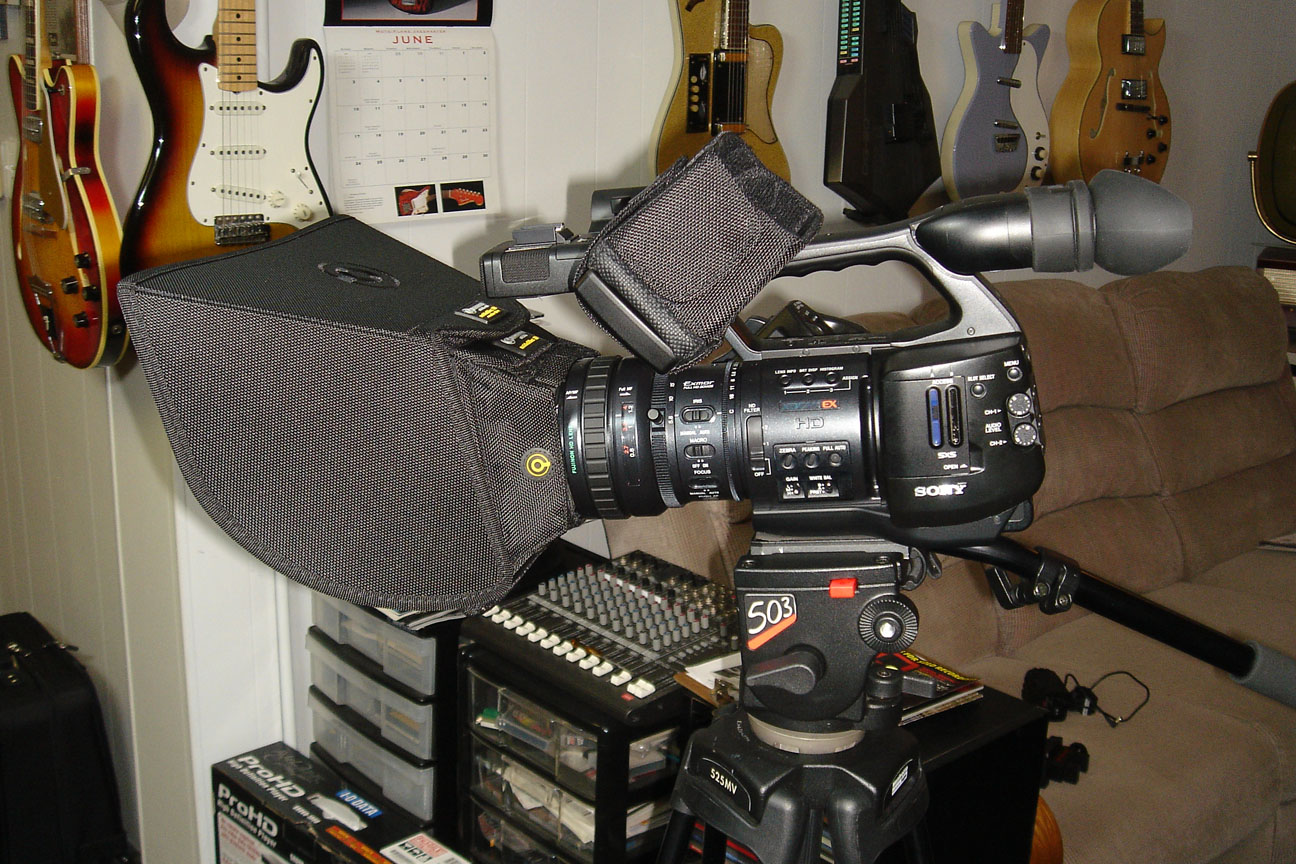

Has anyone fitted the EX with a matte box yet?
I added a 77mm clear digital protection filter, then 77mm to 82mm step-up ring and the Matteblox HD and large flag fits nicely. Nice monitor hoodie too.

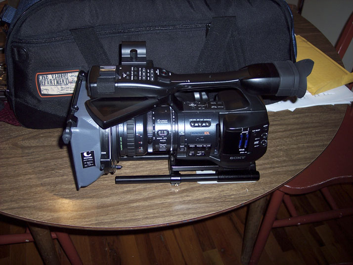

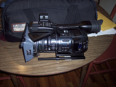

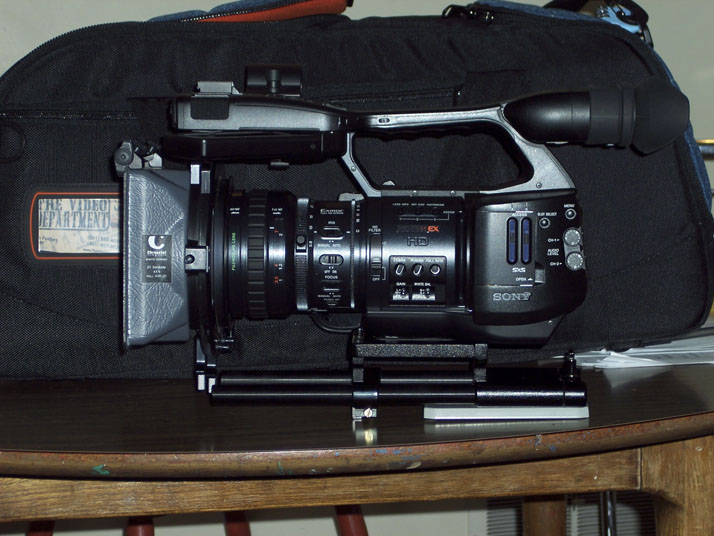

Here is a Chrosziel 4x4 matte box on rods. If only the LCD would close.

I am not sure whether I am seeing it right but did you turn the trays upside down? Someone somewhere suggested that if the trays are accessible from the bottom, the matte box fits with the LCD and all. It would be a pain in the neck when used with rods because it would essentially mean removing the matte just to replace a filter but at least the LCD should close properly.
If only someone could hammer it into the SONY designers' heads that these cameras will be used with matte boxes and most likely with better external microphones so that they stop putting in the built-in mikes and make some room for the matte boxes. How bloody difficult is this?

I did turn the trays upside down. And with the mount for the matte box at the end of the rods they go in and out easily. I just need to figure out that LCD thing.
