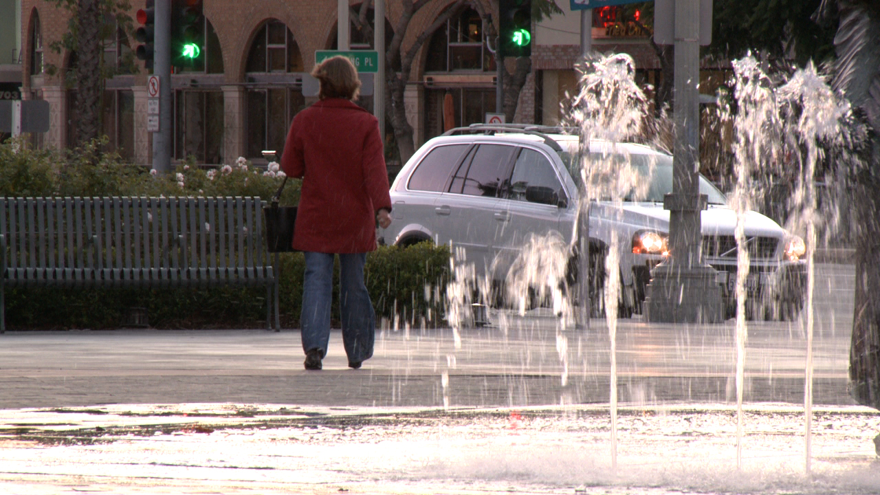

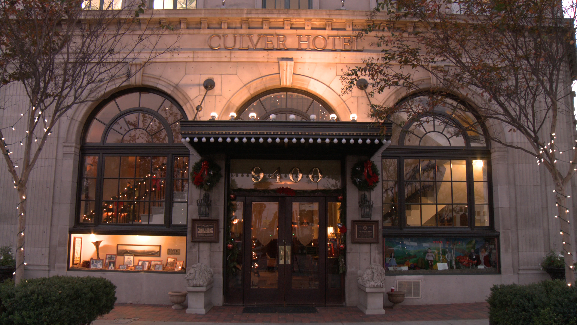

Some Grabs with Detail Off
These were shot with detail off and standard gamma 4.
The first is 720p and the second is 1080p.
They are full quality jpgs.
I didn't CC them at all, but I think the Photoshop conversion may have re-gamma'd them, as they appear a bit dark here.

Eric thanks,
detail off looks great, good detail without the harsh edges.
Interesting, detail ON and set to default all "0" settings looks great
without adding much artificial look.
The sensors seems to hold better detail than others I've tried with detail off.
I'm impressed.

Eric,
these are really nice. i think the edge enhancement is making a lot of the other images look pretty bad, for example the ones that steven linked too on the 'a few more grabs thread'. You can see the ringing around the small highlights which i assume is edge enhancement being dumb and sharpening those highlight transitions, whereas the little lights in the 1080p version here are much more pleasing.
Out of curiosity did you do any footage with the enhancement on to compare?
cheers
paul

I did not do an A/B test - but I will do that next time I shoot with it.
I'm very happy that the camera behaves well with no edge sharpening - this much better for visual effects - one of my primary uses for the camera.
My sense is that shooting at 1080p and downresing to 720 at 4:2:2 with no edge detailing will make for some great green screens.
I'll be testing that soon as well.

This is awesome!
This is exactly how a camera should look. (in my opinion of course)
This is also where the real beauty of native resolution chips really comes through. A good camera shouldn't need a lot of edge enhancement.
I agree this camera should be the ultimate VFX camera.
Thank you so much for posting those images. They almost look photographic.
Another nice reason for this is if you want 720p material to shoot with but may later on blow up to 1080p. blown up images that are sharpened do not look as good as blowing up a raw image and then add some sharpness to the 1080p version.

I agree.
The more I look at those two images with no detail added, they really do look organic. The colors seems to blend real smooth without harsh edges.
Some may say they look a little softer, of course they do.
But, all the detail remains intact and not exaggerated.
