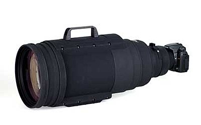

You can get a Letus Extreme and this lens ;)
H

I put a 200-400mm lens on the adapter and discovered significant vignette and chromatic aberration issues, together with any bump and wobble is easily transferred through the rig, as it is long and heavy and much of the weight extends away from the pivot point on the tripod. Start thinking about getting a solid head. At 400mm, I was only achieving the same range as the camera lens. I strongly recommend testing/renting before anyone entertains the idea of using extremely long lenses with 35mm lenses adapters. btw, I understand that Herminio was kidding.

That's one of the funniest things I have seen in a long time! Hilarious. Can you guys imaging the EX1 with a Letus and that Lens?! That would be one funky looking setup.

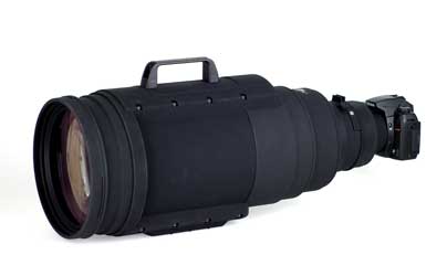

Matt, I apologise if my explanation was not clear. The issue does not pertain to the EX1 (I am still waiting for mine), it is with regard to a video camera, a 35mm lens adapter and a long 35mm lens. As for footage, I recently deleted it all, as it failed for my intended use. Here is an early configuration of "The Weapon", pre-support lock off for the 400mm lens, and has a 2x extender inserted (and imagine I added the Extension Tube(s)). http://www.siliconcine.net/Brevis/Th...licon_Cine.jpg
Correction to previous post, Sigma 135-400mm f4.5-5.6 D, with a 2x teleconverter added, making it effectively an 800mm mess. Part of the CA issues may pertain to the Sigma being a "D" class lens, whereas "EX" lenses are superior build and optical quality. Chaining that much glass together is the biggest problem.

Thanks Chris, looking back, I see that I should have read your post a second time more carefully. Truly though, your pic was worth my error. Success or not, that is a fantastic looking set-up. Reminds me of seeing the Apollo 13 at Cape Canaveral. If you fail at your adapters I bet at least nasa will give you a job.
