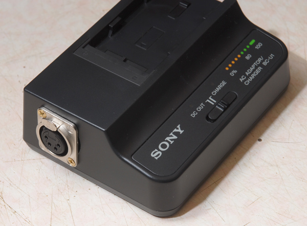

Thought I'd resurrect this thread with a mod I did on my EX1's power supply. I originally cut off the original coaxial power plug and installed a 4-pin XLR on the end of the cord. However, I got tired of having that little "pigtail" hanging off the box all the time so I put the XLR on the box itself. Then I made up some new power cables using mic cable with the yellow-tipped coaxial connector on one end and 4-pin male XLR's on the other. The one thing I didn't get perfect was the size of the hole as I didn't have an exact match for the diameter of the XLR body....got mine too big but it's still solid. Plus, I'll probably replace the screws with rivets.

Where did you find the screws to take this apart?
I guess they must be under the label on the bottom. Did you just take the label off?

I have to give Steve Cahill all the credit for this mod. I took his idea seen here:
Sony Charger for the EX1
I copied his mod originally using the same "pigtail" XLR4 attached to the charger unit. However, I got tired of the cord dangling off of the box so I simply put the socket on the box itself. No loss of functionality but be careful of the internal electronics. If you do the same mod, move the XLR over to the right about 3 or 4mm and you'll have no problems.
