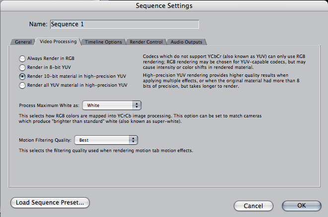

Originally Posted by Matt Daviss View Post
Just throwing 720p50 onto a DV PAL timeline and rendering it out provided results that didn't quite match the DSR-450 (that's an example of English Understatement). It wasn't horrible, just disappointing in comparison.
The image was lovely, luminsecent, radiant, rich in tonality. It just lacked the sparkle and zing of the original 720p footage. The zing and sparkle was in the DVCAM footage from the DSR450, and I would have said the EX1 matched it at native 720p (and you could buy two EX1s and more for just the DSR's lens).
I think the problem was in the scaling method...
It sounds like there is a problem converting from rec 701 HD to the rec 601 DVCAM timeline.
You might want to check your sequence settings. You should make sure that FCP is not set to render everything as RGB... because that also causes shifts in tonality.
Here is the dialog I'm yammering about. You always want the "Render all YUV material in high-precision YUV" selected, but its a compromise between speed and quality. These days for SD sequences its fairly painless to choose the top two options- even on a MacBook
There may also be some proxy settings to adjust, but I don't think that's the case.
What I'd suggest is that you edit your HD footage on an HD timeline, then drop the edited sequence into your DVCAM sequence.
On other thing you might want to consider is using a 4:2:2 codec, like ProRes, instead of DVCAM for your SD sequence. There are some colors that won't ever translate from XDCAM to DVCAM. They may show up in a better quality codec.

Right. Very unscientific (and I'm not referring to any notes here), but I tried
- to DV interlaced, default settings
- ditto, with Best and 10 bit High precision YUV
- to DV progressive (i.e. fields set to None, not Lower)
- the same, with Best and 10 bit High Precision YUV
I then tried adding a tiny smidgen of sharpening (FCP internal at 10). This was because I turned detail OFF on the camera. The person I borrowed it from had default settings, and I found the edges a little too zingy to my liking.
I was using a JVC 15" CRT monitor (not exactly Grade 1, but good enough) to view the FCP via FireWire to an M15 deck, then out to S-Video to the monitor.
The result for DV?
Setting to Best as per your description, ensuring that fields are set to None. I could also make a setting that would crop the 720p into a 4:3 hole.
If I get the chance, I'd like to do the same with 1080p as at 720p I think I got a small scaling artifact around edges just off horizontal that the sharpening drew attention to. I feel a bit guilty about saying this, but I think just the hint of sharpening seems to work too. Perhaps I should put Detail back on in the camera and repeat the tests.
So yes, I've now seen/achieved SD output that's streets ahead of the Z1 and almost equal to the DSR-450, just the DoF sets them apart. However, that's assuming I want 25p (which I do).
I tried putting 50p on a 50i timeline (so theoretically every frame should fit into a field), but it didn't seem to do that. I saw no field activity going on. But fields are so-o 1932 that 'am I bovvered?'
