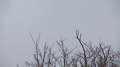

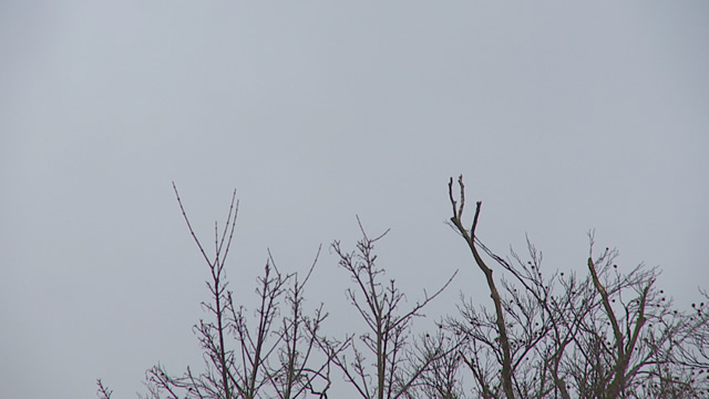

OIS was off and I didn't notice the effect until I reduced the video in size to 640 wide (it was for web delivery). Once reduced the effect seemed to be more apparent.
It doesn't look as bad as yours though, probably due to the OIS being off. Personally I'm not worried about it for my needs but it certainly ruins that shoot you have posted.
Screen grab attached
Paul
