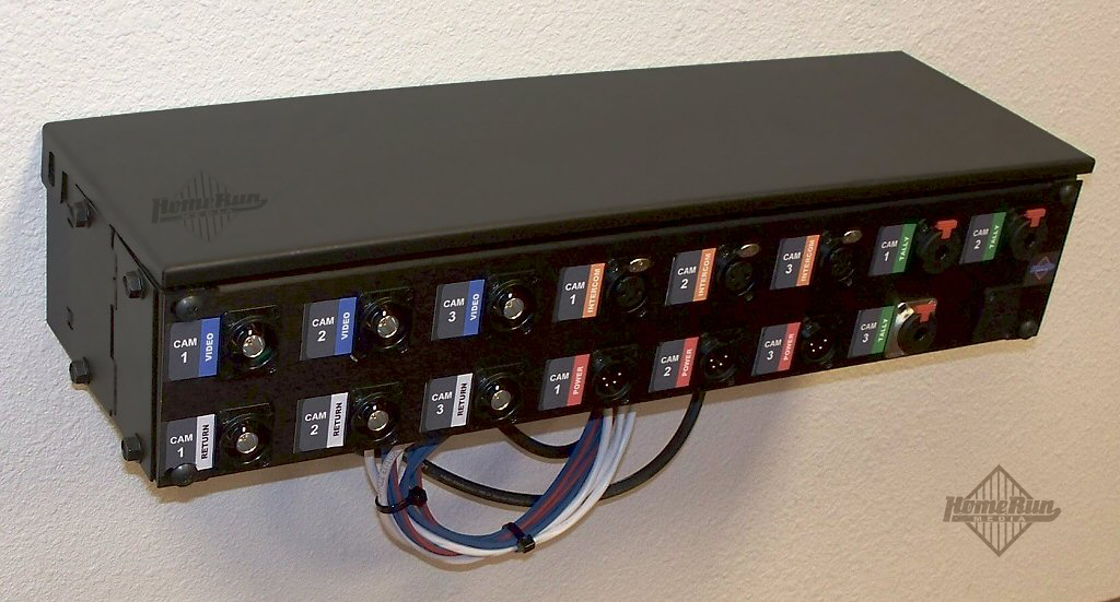

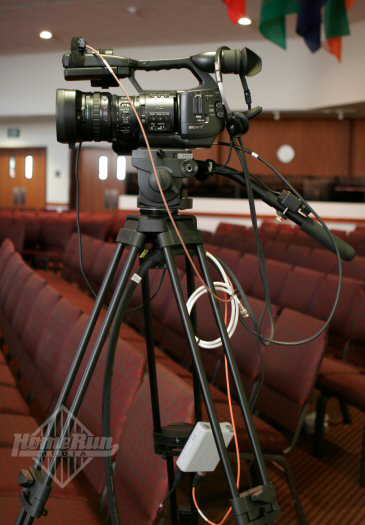

I used Edac EA1060A-57 and ED1050A-120, which supply 15V and 14V respectively, to compensate for the really long cable runs. Upon measuring, the head end voltage was a bit higher than rated, and the cameras got around 14.1V. So I'd recommend 12V and 13V supplies.
Indeed, the Edacs were cheaper than the BC-U1, but the main point was about voltage compensation, and getting from the DC Out wire to the camera. The units are buried in a machine room rack, and the camera now gets one neat cable. Perhaps a couple of photos would clarify: the patch panel is in the machine room, and on the camera you can see the end of a camera cable, which splits into 2 HD-SDI, intercom, tally, and power.
