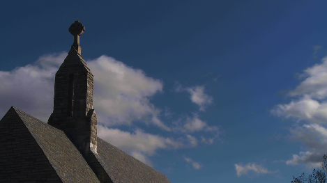

I got my EX1 yesterday and took it out for a spin today. I shot some time-lapse footage of clouds against a church steeple. When I got the SxS card out and viewed the footage in the computer, the two time-lapse shots showed significant banding.
The photo attached was produced by importing the clip into Apple Color, but it is an accurate representation of the clip as viewed through FCP and Quicktime. The clip was shot at 720P24, 35 VBR.
Has anyone else encountered this? Is this banding found on all clips, or is this an artifact of the high-or-low speed recording?

I think it was found to be an issue with time lapse - there's another thread discussing it.

Yes, I saw this problem too using 1 fps with S&Q Motion. Try using the Frame Record function instead, it produces better results at 1 fps.

Steven I have had this problem when there is not enough light. With proper exposure it seems to work great.

I also don't think this problem has anything to do with gamma settings, it happens at 1 fps but not 5, so something else is happening here.
