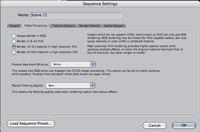

Originally Posted by Evan Donn View Post
Do you have a reference for this? I could swear that I've read in FCPs docs that all internal processing is done at 4:4:4 (at whatever bit depth/precision you have selected in preferences) and then downsampled to the timeline's format.
The sequence settings panel, which I've a attached a screen grab of for you to peruse, supports part of what I am blabbering on about.
You can set rendering precision. 10 bit materials are rendered in 32 bit floating point (FP). You can force 8 bit materials to render in 32 bit FP
Now, I think some confusion sets in in that FCP creates all GENERATED imagery in RGB at 10 bits per channel. (32 bit RGB)
Another point that might confuse a reader is that in Volume 3 page 650 the manual says, "By default, render files are created at full quality, but you can speed up rendering by choosing lower-quality options in the Render Control tab and the Video Processing tab of the Sequence Settings window."
This has nothing to do with bit depth or chroma subsampling.
Finally if you are stupid just like me, as opposed to in your own peculiar way, then you may have confused material you read in the Shake manual with stuff you read in the FCP manuals. Man that still drives me crazy.
If you do a crossfade, that's done at the color space of the sequence. If you want that to happen in 4:4:4, then you have to have a 4:4:4 sequence.
This is standard amongst NLE's Quantel, AVID, FCP you name it.
This is a smart optimization by the software engineers. The majority of "rounding errors" will result in color levels that are unsupported, not colors out of gamut- even in 4:1:1 or 4:2:0 color spaces. So, you waste CPU cycles on extra bits and that makes a difference. Wasting them on increased colorspace is actually a waste. You are limited by the output codec- so never bother exceeding its capabilities.
The relevant section is in the Final Cut Pro Manual Volume 3 page 659.
If you are going to 32 bit processing though you may want to read Volume 3 pages 241-252 which contains notes on which effects are disabled when you are working in high precision YUV modes. HINT: Most of them.
Compositing software, like Shake, NUKE or Flame works in 32 bit FP all the time. Of course they work in RGB space, causing a whole different set of headaches.. but hey that's the game we are in right?
If you need an NLE that works this way then you really need a "Finishing system." I think AVID DS, Autodesk Smoke, Autodesk Fire, and anything from Quantel are the only NLEs right now that can work in 10 bit with all features all the time.
Avid Symphony Nitris is mostly 8 bit, but it offers 10 bit titling- sorta like FCP just wicked fast. Of course 8 Core Mac is also wicked fast- but Nitris can be wicked faster.
Enjoy
