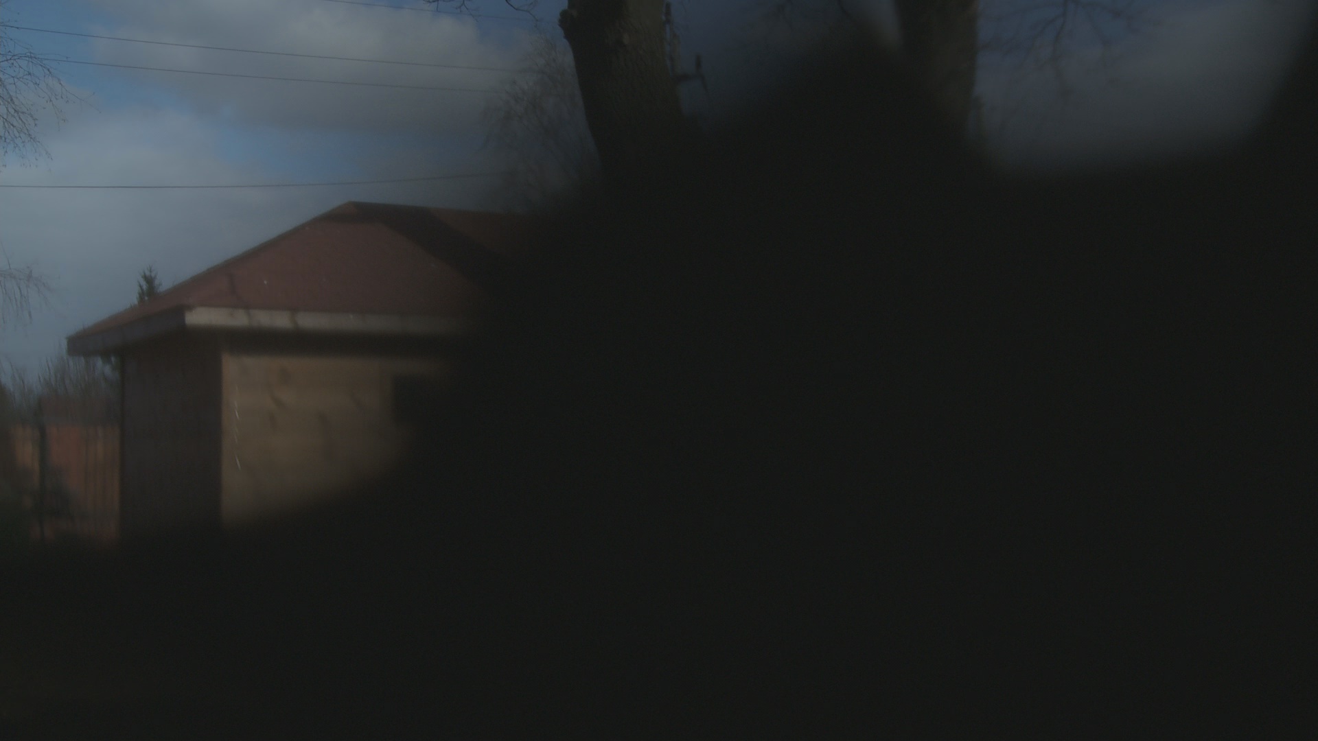

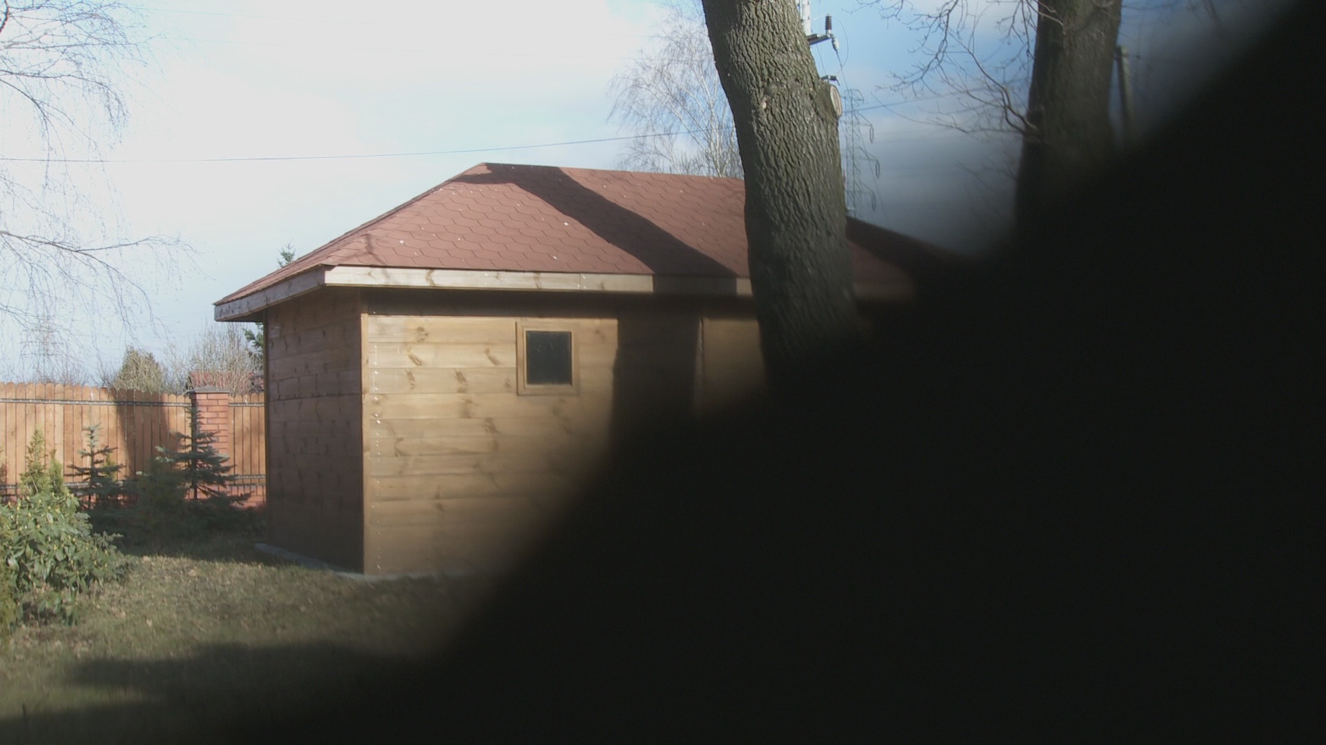

I have mentioned about it already elsewhere, but decided to make it a separate thread because it's more serious than I hoped it was. It happens to me more and more often, that the filter doesn't snap completely and firmly into position, and partially obscures the picture (see grabs below). The most common situation is trying to engage the ND1 (middle possition) from either ND2 or OFF position - sometimes it will go too far, and end up between ND1/ND2, or between ND1/ND2, respectively.
Before I send my camera for repair, I'd like to know whether this is an isolated case or if it happens on every unit. I'd prefer to wait until Sony is made aware of it and develops some effective fix, rather then send the camera at once and let them experiment on my unit...
Therefore, please everybody observe yours and comment in this thread. Thanks.

Old February 9th, 2008, 09:14 AM   #2
Location: Juno Beach FL
Posts: 169
Yes it has happened on occasion where it has stopped in a viewable position. I try to be precise and deliberate when I change it. Has yours become stuck in that postion?
You mean, stuck for good? No, it's possible to be corrected with a more deliberate and precise switch movement, but still...Should NOT be happening!

This very same thing happened to me today.

Happens if I'm not aggressive and firm. Stupid thing, like the power switch needs a lever pointing out. In fact I'm thinking of drilling an ever so tiny hole in the middle of the two switched and putting a small self-tapping pin in so you can get a good grip with the end of the finger. Also thought of epoxying a few grains of sand to the switches to give them more purchase on the fingers.
Exactly what I'm planning to do - there should be a lever, not slider, to operate it quickly and firmly - the only thing is I'm afraid it could void the 2 years of my warranty...

I've still got a minor vignetting issue and if I try hard yes I can get the ND filter between clicks. It's easy enough to test what you're getting at, just estimate how far the edge of the filter moves out of the frame as you move it.
One thought though, it's pretty cold where you are now, mechanisms tend to bind in the cold. There is on my camera a quite definative 'click' when the filter is in the correct spot. Come to think of it I'm pretty certain I could get any camera, even a PD170, to half engage a ND filter, don't know what that proves though.
Thanks Bob, I see your point. However, whereas on other cameras one needs to really try to get it half-way, on the EX1 one needs to really try to get it where it should go... And yes, there is a "secondary", inside click when it snaps in the proper ND1 position; it's very easy to jump over it - it's not "deep" enough, if you know what I mean. And considering that - without a lever - one must exert a considerable force on the slider (especially to move it up from the OFF position), it may and WILL happen quite often, I'm afraid.
Installing a lever and/or a grip of some kind on this silly, recessed slider is a must for me... But you're right: with temperature change (and with wear) the problem may vanish (or increase).
