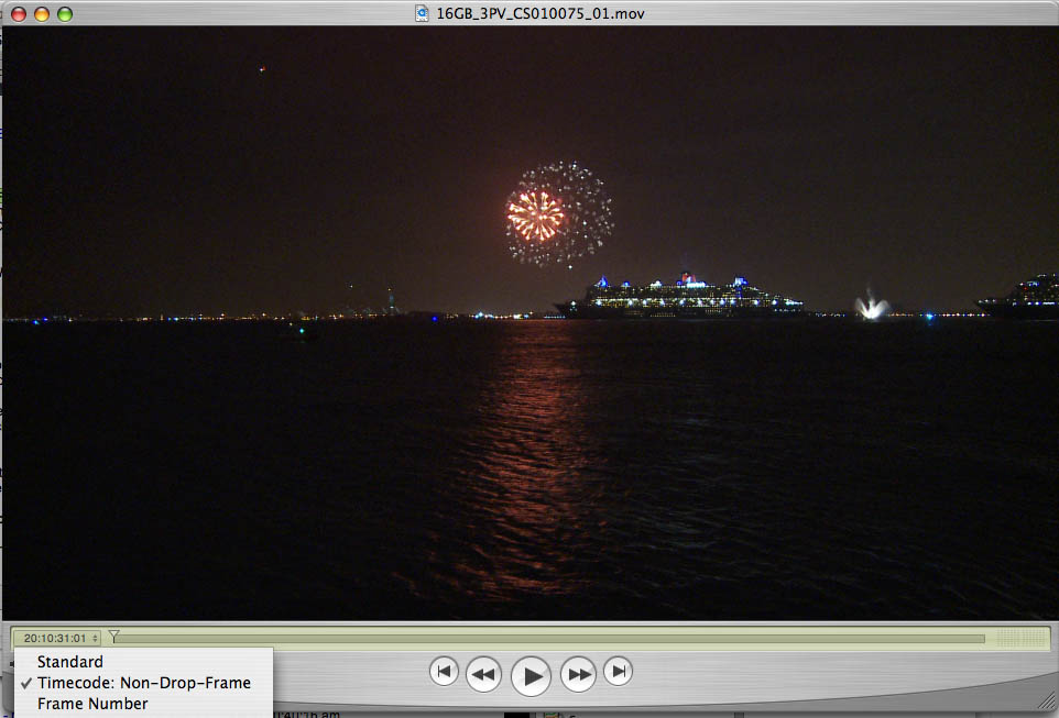

I'm shooting 1080p30 so Clock mode (Time of Day) SHOULD be Drop Frame. That's not what Quicktime or Final Cut Pro 6.0.2 is seeing. Both show the "flag" set to Non Drop Frame.
Interestingly if I jog through Quicktime passed a minute mark the frames ARE DROPPED :29, :02 but Quicktime sees it as NDF.

See attached screen shot from Quicktime 7.3.1. In lower left it is Clock time shot at 1080p30 and should be DF but Quicktime shows it as NDF.

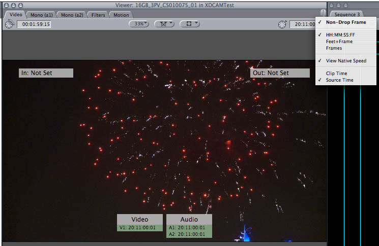

This is screen grab from FCP 6.0.2.
Note in upper right it shows as Non Drop Frame.
Note in time code display in bottom center of image the time code number of 20:11:00:01, a number that should NOT exist with Drop Frame Time Code.
BTW in Quicktime the above number does go from 20:10:59:29 to 20:11:00:02 as it should but Quicktime (as I noted previously) show the NDF Flag.
What I'm seeing:
Quicktime shows correct DF numbers but flags as NDF
FCP shows NDF numbers and flags as NDF
Shooting in 1080p30 should be DF.
