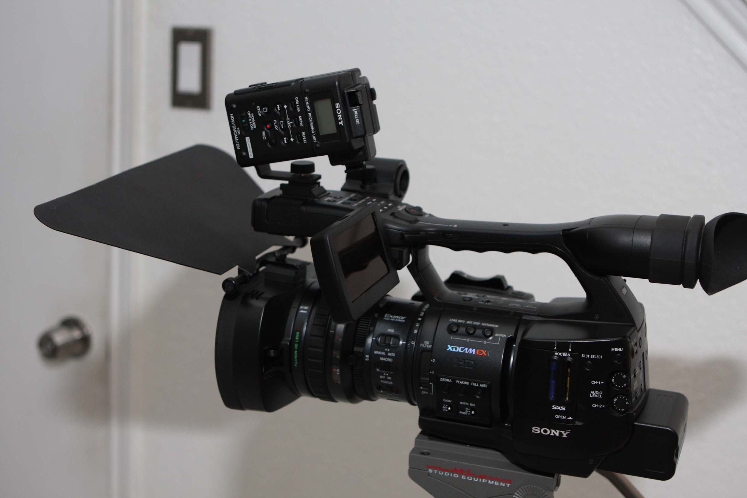

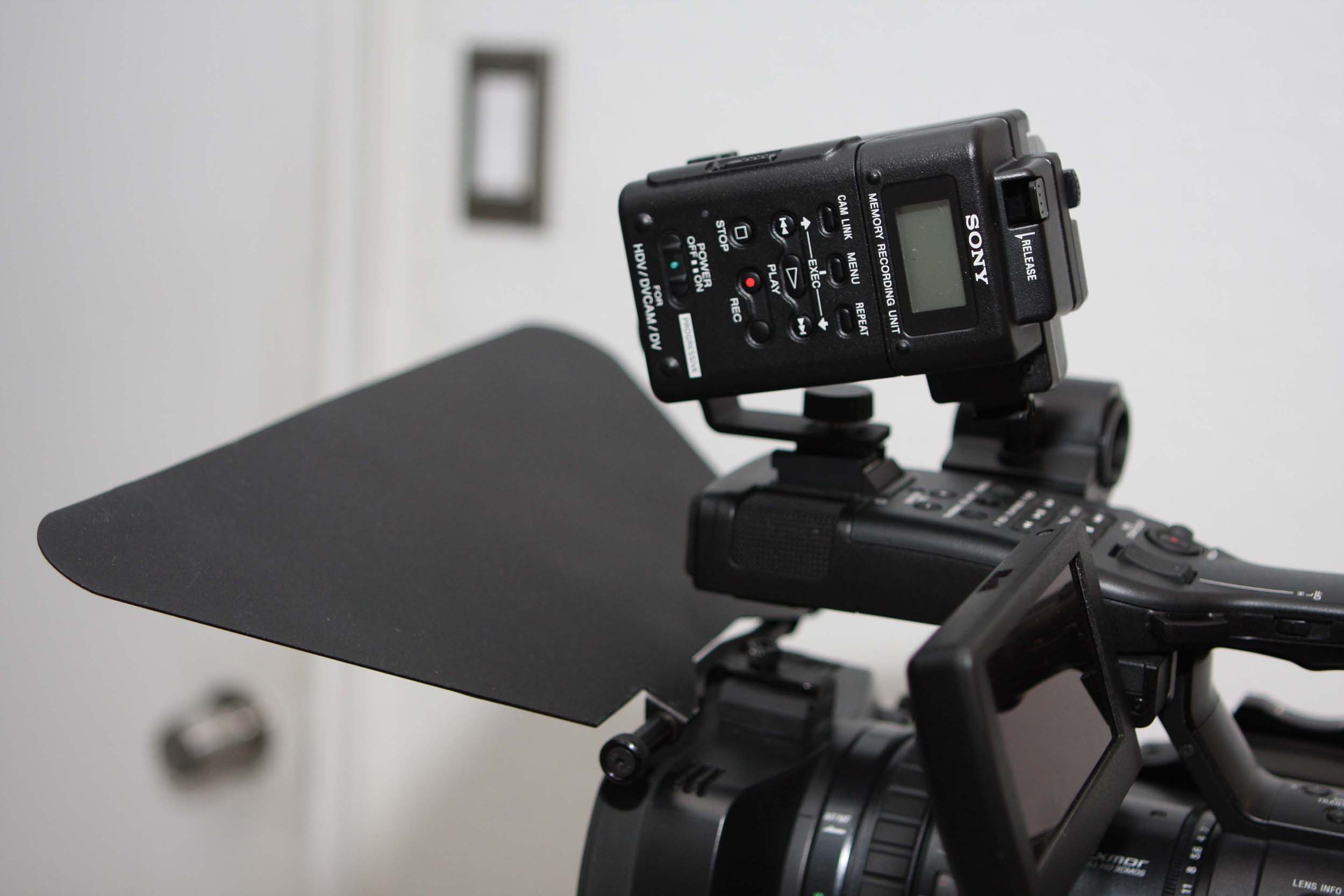

I tested the XDCAM EX with the Compact Flash Recorder from my HVR-z7
works in SP mode only. I used the bracket from the DR60 to mount it to the EX. See attached pics
XDCAM EX with Compact Flash Recorder-xdcamcf1.jpg   XDCAM EX with Compact Flash Recorder-xdcamcf2.jpg

Ordered the french Flag from ebay glued the shoe on with a Product called GOOP the shoe mount is from Houston Camera Exchange part no RS-3111P RPS SHOEMOUNT ADAPTER item no 718977331118

The CF unit is from my HVR-z7U cam it aslo works with my HC1
HVR-MRC1 Memory Recording Unit Kit . I plan on ordering another one if it is sold seperate from the Z7U

I'm not Brian, but I'm using the DR60 HDD in a similar fashion, and the answers are:
- in SP only, as in HQ the HDV (i.LINK) output is cutt-off
- yes, you can set recording to i.LINK device alone, or both the SxS and i.LINK simultaneously
