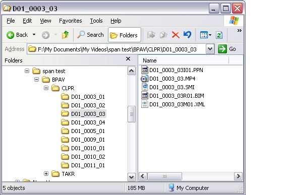

Exactly Peter - when I say "copy", I mean the Clip Browser "Copy" function, not the Windows Explorer copy! In the Clip Browser I select all clips on the mounted card (they all may be just chunks of a long take - created either due to the FAT32, 4GB filesize limitation, or the SxS card capacity limit exceeded), select Copy and point it to a prepared directory on my PC's HDD. Then I mount another card and repeat the Copy process (to the same directory; not any separate subfolder!). See the attached dir tree as resulting in the Windows Explorer below; I copied two card's worth into a directory called "Span test". The clip D01_003 consisted of 4 chunks; the first 3 were created because of the FAT32 limitation, and the third was additionally span across two SxS cards.
It creates the right structure automatically, and displays the combined files as a single clip in the other Clip browser's pane. Then, and only then, I can select it as a whole, and export the seamlesly merged mxf.
