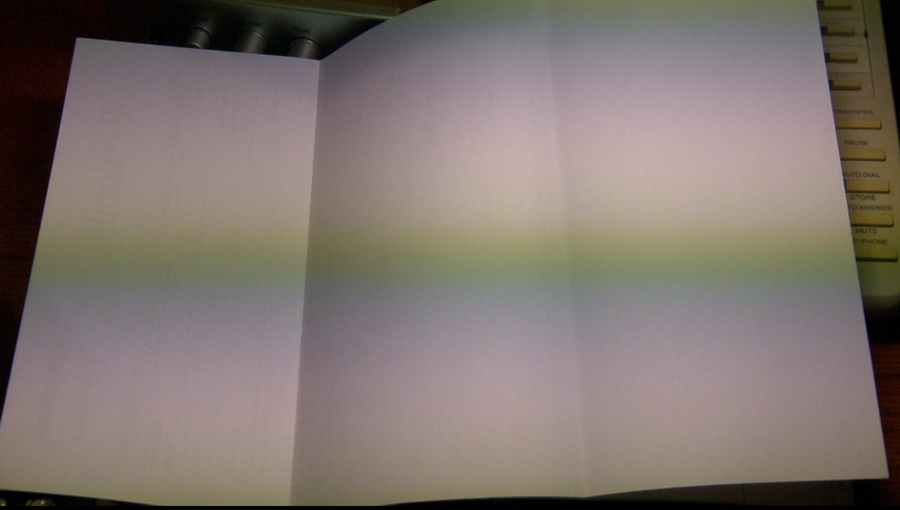

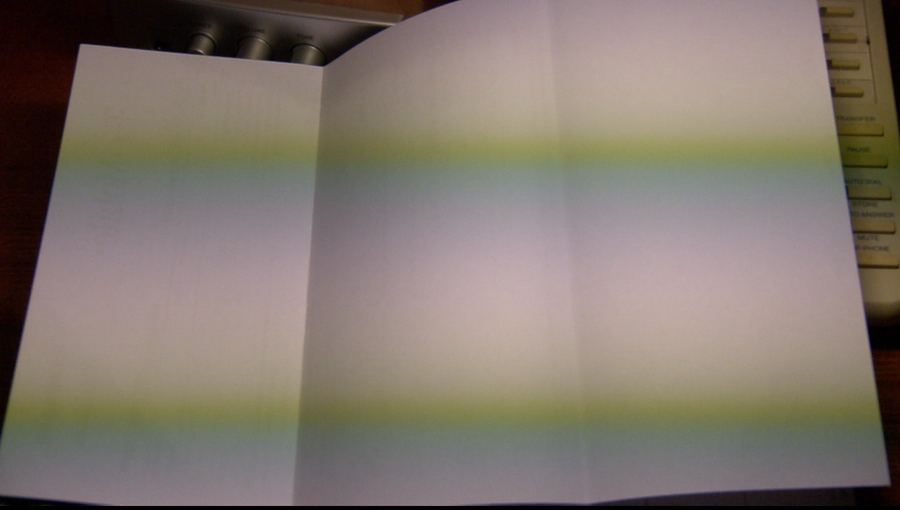

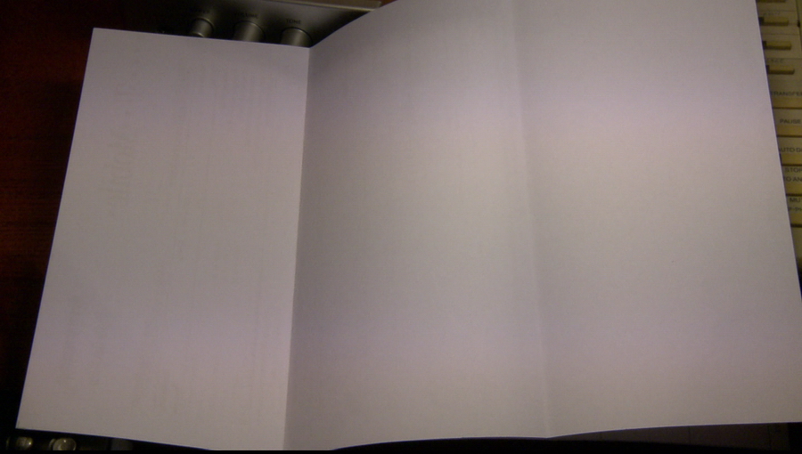

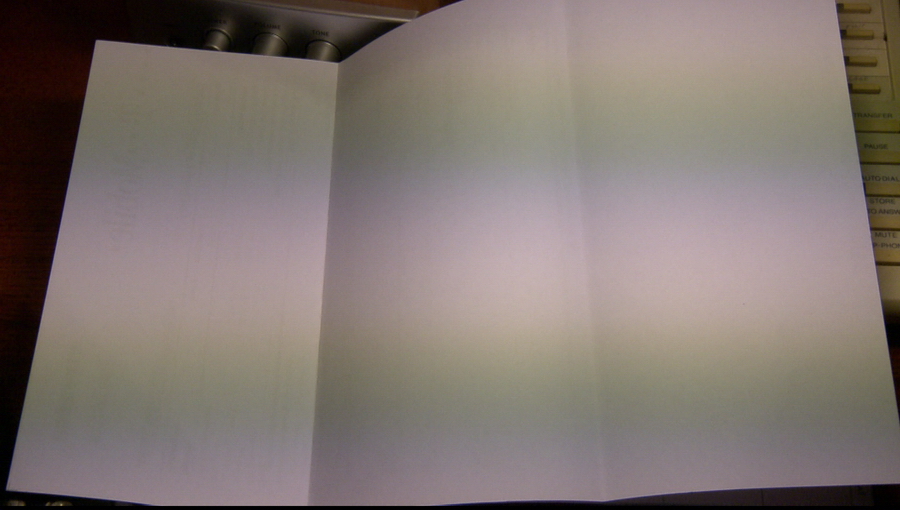

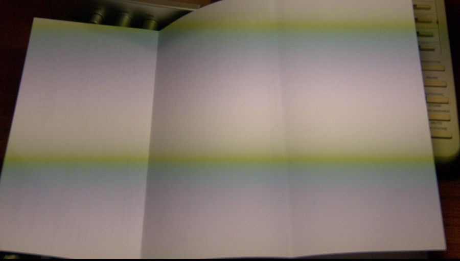

Hi all,
i want only inform on next issue. I find some strange in higher shutter. When i have set higher shutter like 1/125 and more. I see this lines only in indoor lighting. Outoor i dont see this lines. This lines going slowly from up to down.
I try 3 another EX1s all have this issue. If is this issue. FW is 1.03 .
For me isnt this big issue i dont use higher shutter indoor but for someone maybe is.
Two lines in higher shutter-ex1_2000.jpg   Two lines in higher shutter-ex1_1000.jpg
Two lines in higher shutter-ex1_500.jpg   Two lines in higher shutter-ex1_250.jpg

This is due to your lighting source.
Yes, you are see the CMOS rolling shutter.
What kind of lighting fixtures were these?

Zenes, try a tungsten light, the lines should dissapear.

Fluro or HMI lights with electronic (aka HF) ballasts will eliminate the problem.
Low wattage incandescents might still give you problems.
