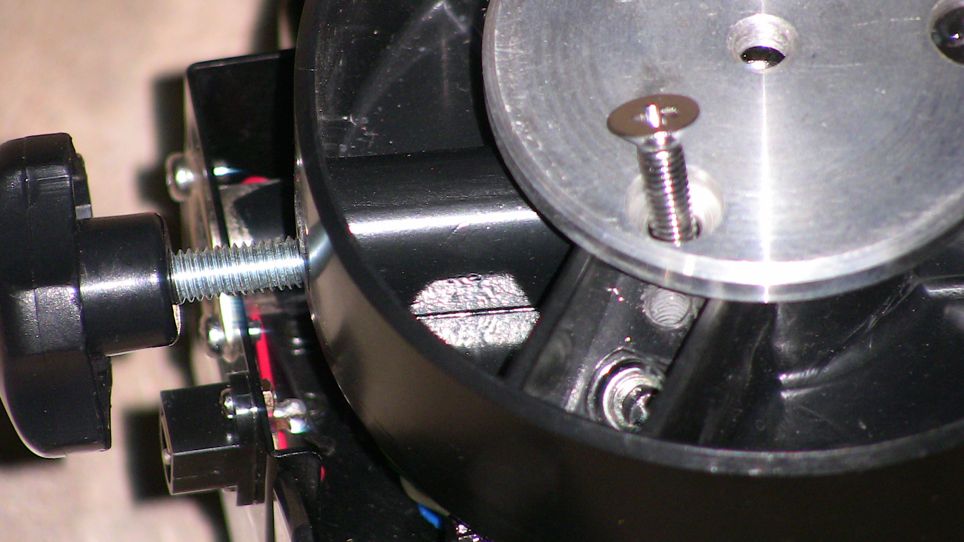

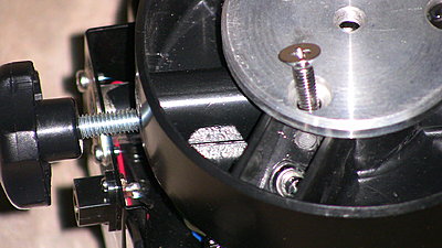

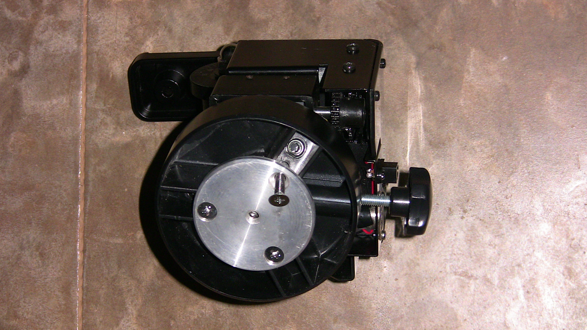

The unit I got fell apart in 5 days of light duty and I'm always super good with my gear.
Metal screwed into plastic is what this is. The base plate that attaches to the tripod is metal but that is attached to the rest of the Motor mount by 3 little screws that screw into PLASTIC. 3 Tiny screws in plastic holding your camera while you scramble through the world. One of the screws had started coming out so I went to tighten it only to find that it was already stripped. That's why it was falling out. I took out the other 2 screws that were holding only to find these were all that was holding the camera! Crazy. What's even more crazy is that someone who assembled my unit mismatched the base plate so instead of threading the correct screws into the inset metal threads (imbedded into the plastic) they cheaped out and screwed them into the plastic. Zero quality control. Then the pan lock stripped it's plastic threads as well. The pan lock is necessary or the unit won't pan.
I just got a reply from Mizar which basically said that the unit was meant for light duty hobbyist telescope work and the pros video will often buy several units in anticipation of a failure.....
So, if you are serious about a head thad will stand up to more than just light puttering around in grandma's back yard forget this one..... or buy several of them.
