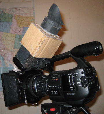

Serena: My problem is not so much technical as my poor eyes and the very bright desert. As i said over at the "High Light" post I have not found a hooded setup that allows me to use the LCD and the viewfinder is poor so I'm having problems just seeing the Zebras so i think I'm being over cautious. Last Spring when it was not so bright I had no problem but now I'm blinded by the light.
Perhaps the answer is to add an eyepiece to your hood (copying the EX3 approach). If I knew how to link in a photo of mine, I would. Maybe this? http://www.dvinfo.net/gallery/showimage.php?i=961
and this
http://www.dvinfo.net/gallery/showimage.php?i=962&c=2
The eyepiece is made from two +3.5 diopter spectacle lenses (making 7 diopter). Flips up for direct viewing of screen. Made of 6mm foam core, so very light, if not convenient enough (doesn't fold) for normal use -- just a proof of concept.

Alex, I did in fact build one of these but with no lens but made for both eyes. It was too heavy and strained the LCD hinge. Can you disclose what you are doing?
Mike

You mean like this/ Made since my last post. It has a graduated vari-focal lens in eye-piece.
Mike

Mike, yes, that's the way. Actually you shouldn't need a graduated vari-focal, but I guess you had that on hand; single focal length is what you need. I bought a pair of generic "reading glasses" and took the lenses out of the frames. $4 at the bargain shop.
Serena: You got screwed. 99 cents here for reading glasses in the 99centsonly store!
The vari-focal is there because I'm in the process of surgery on both eyes and they are always changing and I have no prescription lenses at the mo., and as you say, it was on hand.
Another feature of the one I made and shown is that the tube telescopes, so I can use it to focus.
Mike
Mike Stevens is offline   Reply With Quote
Old May 14th, 2008, 11:17 PM   #52
Posts: 640
Images: 3
The focusing feature is a good idea and I'll add that when I get to prototype stage (fixed is fine for a single user).

For me, my telescoping unit cost only the lens from a discarded pair of specs and a cardboard box. I had to steal the eye cup from the viewfinder when I realized I did not have a spare. Funny, the Z1 had two eye cups and I only just now noticed the EX1 only has one.

So the question is: why do you want both? Everyone agrees that the EVF isn't great -- useful but not up to the standard of the camera. The LCD on the EX1 is the same as on the EX3 and the obvious thing is to copy the EX3 approach. The problem, as Mike mentioned, is that the EX3 has a much more robust mounting for its LCD, so one has to be careful in translating the EX3 system to the EX1. However our simple "proof of principle" tests have shown it is possible and so effective that I have switched off the EVF. Now for some work on developing a very light-weight yet robust prototype hood. Maybe the EX3 hood is the best answer; but it will be expensive and may be too heavy.
